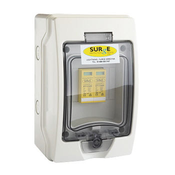

Mrs Pete999 has been whinging about getting one fitted, now I want to fit one for whole house protection, not sure of what to get, I was wondering if anyone has any preference as to make or type, unfortunately I have no room in my C/U to fit one so it will need to be a stand alone module, the ones I used were Furse, all differing types depending on the size on the installation, has anyone any info they could pass on to me please.

Generally if you are trying to protect from lightning strikes then a class I would be required; in a domestic house then probably a class II+III would be fine, you are probably looking at about £100 to cover this and just remember keep the cables short!

I'd be going with type 2 at source then type 3 on outlets for sensitive kit.

Thanks Gavin, but as I said in my post I have no room in my C/U, hence my search foe a stand alone module
Cheap and cheerful and simple, I have no idea about the make of these normally Dehn or Furse seem popular but it is straightforward.
