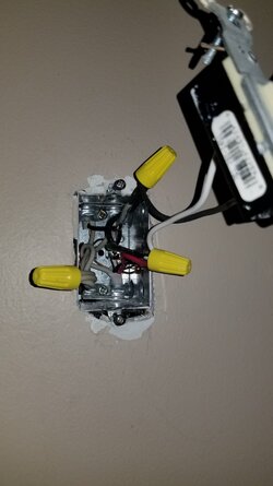

I tried to put in a smart switch, which should be simple enough but when I took the plate off I was surprised at what I saw.
There are two lights controlled by the switch, but still single pole switch. The feed wire is three way with one hot going to one light and the other hot going to the other light. All neutrals are bundled together. What should be the neutral is connected to the red feed wire. Bottom is the feed, top two are the lights.20190729_201343.jpg
youm sure it's not a 2 way switch? pic. not clear enough to see what goes where.
seems to me there's 2 black and a grey in the switch. or is 1 black shadow?

I'm struggling to see exactly what goes where in your photo. Could you draw it out on paper and take a photo of that?
Is this what's happening?
If so, then the two phases from your 3 core feed at the bottom are actually just the same phase.
(Didn't have a grey pen, so have used blue for neutral).
Don't assume anything, though: testing will tell you what's going on.
Wouldn't that overheat since the red and the black are both hot supply are reducing down to one hot black?
Your diagram is great! The way it is in my setup is
Light 1 black to feed black to switch bottom.
Light 2 black to feed red to switch top
I was thinking of capping off the red and then doing exactly what you have above. Instead I flipped breaker and called an electrician :)
I think you made the right decision. Hope you get it sorted OK.

That makes no sense at all, that I can see. (Not what you're saying, I mean what you're describing)
Definitely the right decision. :)
