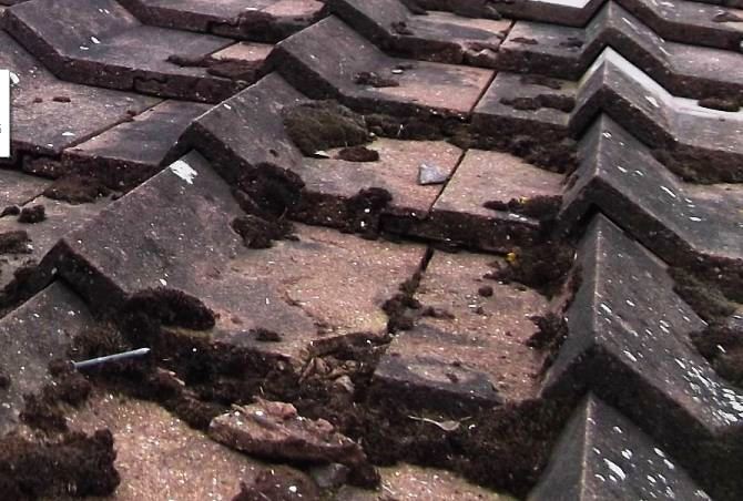

Came across this type of roof tile for the first time recently.
Any ideas what we be a suitable roof hook. Height of tile peak is 50mm above flat surface of tile.
Thanks
Judging by all the bits of tile laying around they look very fragile, not sure where you would get any spare ones from.
The photo doesn't do the roof justice - the tiles (except for one in photo) are in good shape, however, you're right, if any get broken finding replacements could be a problem. There is evidence of some tiles having been replaced but they're not exact replacements and it's alleged they let water in.
K2 Adjustable Pan Tile Roof Hook, RedTip M103 Products-new
Both will do the job.
You WILL break tiles, so you need to have replacements ready!
Try your local architectural salvage yard for spares as other buildings in the area may aslo have been built using them, expect to pay up to £5 / tile instead of the usuall figfure though!

My local yard closed recently - this is where I got all my spares from!
The tile I'll need is a Redland Delta so I'll need to look further afield.

I installed 4KW on the exact same roof before xmas, They are certainly not brittle or weak we didn't break or damage a single tile. Install wise i would say exactly the same as any other concrete interlock tile.
As already said, use adjustable roof hook think we used one from SPV.
