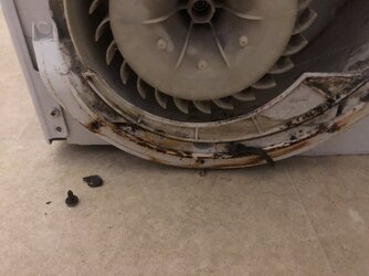

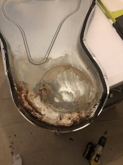

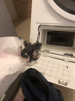

Hi I have a swan stc7020w tumble dryer. It turns on but when I press start it just beeps and doesn’t do anything. Also it has leaked water underneath and had loads of water and gunk underneath the heat exchanger. I had bought it from a shop as a refurb with 30 days gaurentee and conveniently broke on 32 days so they won’t help me out and said it’s now my problem ? any ideas would be really appreciated thanks
I think the first thing is to get the back off and see where that water has leaked from. Also see if it has done any damage to any connections etc.
Obviously make sure it's unplugged first.
Did it go from great to nothing or was there noticably reduced drying before it stopped?
Sounds like a lack of regular cleaning has resulted in blockage of lift pump or tube and that water isn't being pumped from base to collection tank. That would be a clean/flush operation, but would require partial disassembly.
Hi it seemed to worked fine at the start. We did the regular cleaning of everything in it. Here is a picture of some of the stuff I cleaned out from under the heat exchanger. And also when I took off the back this is what it looks like too. Like it had been leaking a long time?

all that was there when you bought it.obviously not been serviced before sale.

Looking at the pictures I think I'll revise my advice to match that of loz2754. That leak has been there some time.

Images tell a very different story to what I'd suspected and show clear evidence of long term leak, the cause of which obviously predates your purchase.
