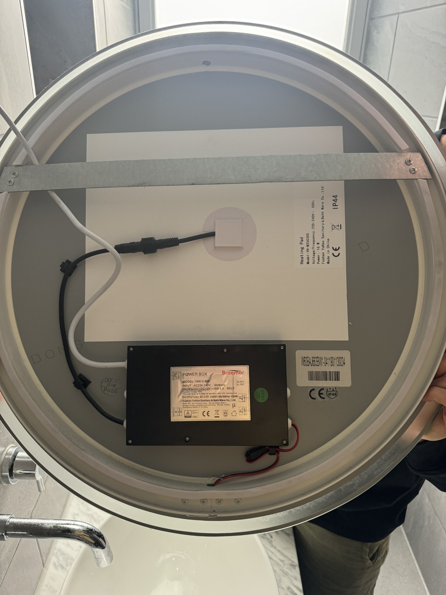

Hi Guys,
Looking to replace my power supply unit behind my bathroom mirror which powers the led strip lights and de-mister on the mirror itself.
Looks like the original product is from overseas and cant be purchased here. Would be great if someone can point me in the right direction as to where is best to purchase a similar product.
Thanks
I suspect the way ahead could be to replace that triple supply with two separate units.
If I'm seeing correctly, there appears to be only one 12V DC supply in use - output D1 - is that right?
ie just one cable to the LED(s)? Can you confirm that D2 doesn't have a wire coming from it?
In which case the LED could be driven from one of these (if it's thin enough to fit!)
The essential requirement is that it's marked 'SELV', as well as having a suitable IP rating.
There remains the job of supplying the heat pad. It's rated at 240V 16W. I imagine the Braemar black box has an isolating transformer for this, so rather than just connecting the mains directly to the heat pad, it would be very much safer to use a suitable isolating transformer. Below is a possibly suitable example:
I'm not encouraging you to do this unless you believe you are competent to tackle all the interconnections.
Connectors and joint boxes would need to be compatible with the bathroom environment and suitably IP rated. Minature waterproof junction boxes for flex are available if you know what to look for.
Bear in mind the safety (or otherwise) of the result would be entirely in your hands!
