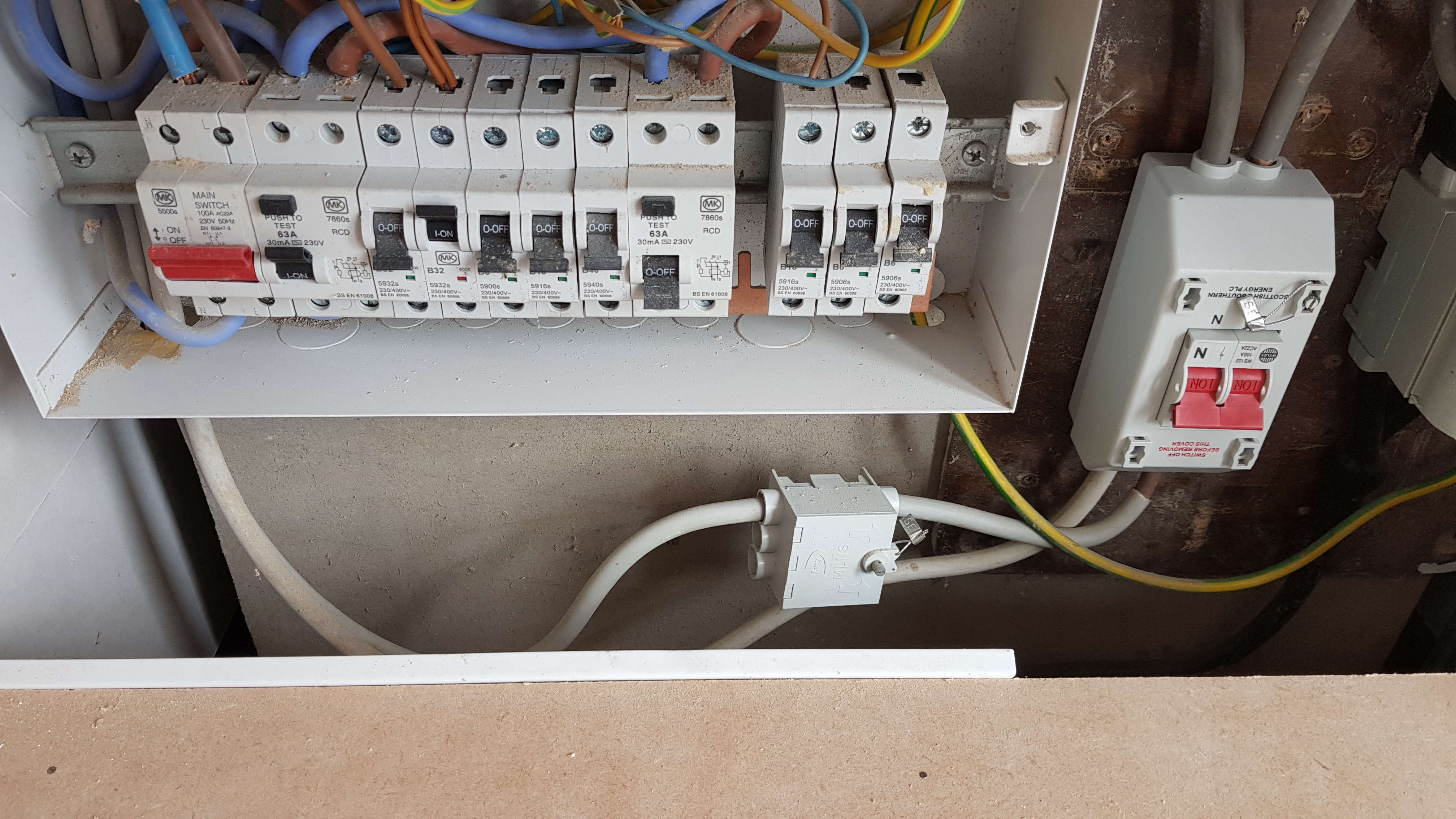

I'm in fixing a re-wire by a handy man and seen that the DNO has fitted a service connector block on the live tail. Sealed and stamped by the DNO?
Why would they do that?
Cheers
On further inspection I don’t think DNO fitted that isolator either.
They are much better than that. Sleaving is not fully enclosed on a couple of the tails on either side from what I can see.
As for the seals anyone can buy them.
sleeving. from the spell check gestapo.
I'm going to remove it, don't even need to break the seals as it's on the consumer side of the isolator, just thought I'd get some others thoughts on it.
I'll speak to the developer, got a potential job of 6 flats to get rewired and I want to make sure he's not cutting corners before I get too involved with them.
