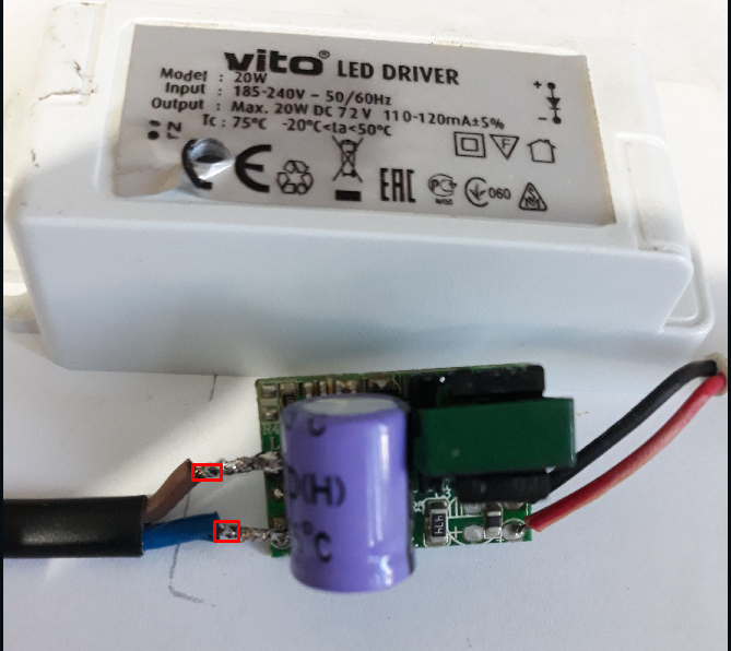

Hello,
I am the artist, (I'm not an electronist or electrician).
I have a weird problem that I never encountered.
I have a small power supply led driver for a power-led wall light.
I want to attach an indicator led running at 240V to its input ( directly on the 240V wires). You can see the 240V input in the picture, in the left side, as brown and blue wires. I marked with red the location where I soldered this circuit.
Here is my circuit. The resistor burned to black totally the first time I mount it and it took the led with it, but it didn't had the diode. Now with the rectifying diode included, is still fumigating and get extremely hot, but I don't let it to burn totally like it's predecessor.

First you need to calculate the power dissipated in the resistor - an amount in Watts. It is this power/electrical energy which is being turned into heat and warming up the resistor. The resistor needs to have a suitable power rating to handle this conversion of electrical energy into heat energy. The resistor must also be able to transfer this heat to its surroundings. Otherwise it will continue to rise in temperature until the materials from which it is made begin to decompose or even burn.
google how to calculate the power dissipated in a resistor.
Cut to the chase - the power dissipated would be (230)² / 68000 / 2 = 0.4W. The division by two is due to the diode blocking the circuit for half the AC cycle. If the resistor is rated at 0.4W or more it should not burn out if it is allowed to cool in free air. Your idea about things coming back out of the LED driver causing damage is unlikely to be the cause. The voltage seen by the resistor is defined 99.9% by the 230V AC of the electrical supply, not by the LED driver. Although a PSU can send high frequency ripple back out of the input, the amplitude is very low (not really 'spikes') and ripple will not damage the resistor anyway.
The diode needs to be 600V or preferably 1000V rated, it has to block 325V minimum as this is the peak voltage of 230V AC. If the diode is breaking down under full voltage then current will flow through the resistor on both halves of the AC cycle and it will dissipate 0.8W instead of 0.4W. So one possibility is that the diode is not adequate for the purpose, it is breaking down, the resistor dissipation is doubled and the LED is also being damaged by the reverse current flow.
The other possibility is that the resistor is not 68kΩ - you picked a lower value up off the table by accident which is allowing much too high a current. We've all done it! By the time you realise there is a problem it is toasted and you never get to find out what resistance it actually was.
Thank you both, mister @marconi and mister @Lucien Nunes for your answers. You are both right.
Hell, that image of the circuit with the 68K in it, I didnt even read it. Wow, what a mistake I did. I posted it only for the circuit itself, but I overlook reading it. Ha. Negligence from my part.
The problem is resolved now. Here is the final assemlement :
Now is working as intended with a 1/4W resistor in it but at a much higher value - of 220k.
In my original blowing up circuit, I used 10k and that was too small value. I built like 50 circuits like this one , but rarely and in time so I always forget the details. Im getting old.
Here is a test I did, putting my finger for reference, I used a 100k 1/8 resistor !!! and a 1N4148. and it run as the rest of these circuits that I build before. I know you dont believe me, because I am an artist, but try to.
So yes, problem solved and really, thank you for taking the time to respond to me.

I would replace the 1n4148 diode with a 1n4007. The reverse voltage of the 4148 is only 100v compared with 1000v of the 1n4007
The other approach is to have the small diode in inverse-parallel with the LED. No worries about diode voltage limits then, but twice the power dissipated in the resistor.
