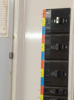

Can I use a 3 pole breaker (originally feeding a massive 3 phase heater) to feed 3 single phase circuits?
I've run seperate neutrals for the 3 new circuits and the breaker is rated for the load required - 30a per phase (I'd be installing 3 x 32a breakers if I could, but the age of the board makes this a pain).
Killing all the circuits in the event of a problem won't be an issue - they're all in my workshop.
So - is it permitted?
There are no socket outlets involved
It will still function as would a single-pole device but you will lose three circuits if a fault occurs on one. Not the end of the world but probably falls foul of Reg 314.2, what make is the board.
Not worried about losing 3 circuits in the event of a fault. Board is a square D circa 1990 full of old black QO breakers.
The whole installation is going to be inspected so it needs to be right - or at least acceptable.
Problem with the device you have reused is that it is a Type 4. How have you proved disconnection times will be met.
A fault on one circuit shouldn’t effect another circuit?
Also because they are all on the same ocpd would it be classed as one circuit not 3?
Oh cool - saw those they're not exactly the same but the look like they'd fit.
I've attached an image - I'm replacing the top 3p breaker.
