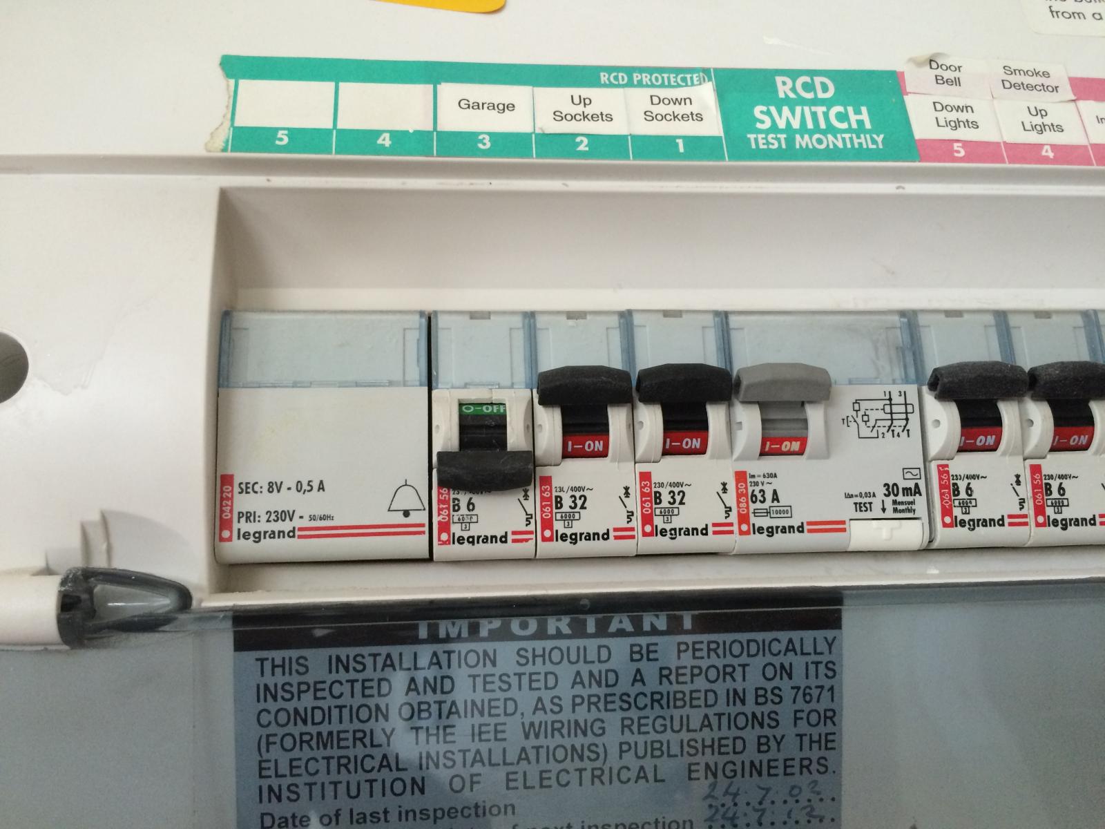

Need a 6A RCBO to fit this Tenby / Legrand board - anyone know if they are readily available?

Yes i bought a 40 or 45 the other week. Not cheap but saved messing about.
I think I ordered mine with eddies, but can check if you have trouble ordering one.
I queried with Legrand about fitting one of their RCBO's in a similar looking CU as yours. They said it wasn't compatible & won't fit?
Somebody else said something similar hence the thread!
The 6a MCB I was thinking of replacing with an RCBO, was a Legrand 06156. Legrand said their current RCBO was incompatible with the CU the 06156 was fitted in. Is that the same MCB as in your CU? Let us know if you find the opposite is true, make my forthcoming job a bit easier. :)

Are you trying to replace the 6A that is in the off position ? as it looks like it is on the RCD protected part of the c.u.
These gray Tenby c.units must be about 15 years old as I think that Legrand took them over and updated the c.u. and JUST rebadged the mcb/rcbo,s to Legrand.
About 3/4 years ago the mcb/rcbo's changed to new type but fit in c,u.

Fyi it's not the 6A named garage, it's on the other non protected side!
I have put a old Tenby and legrand mcb as your photo together with a new legrand mcb and they are exactly the same therefore the new domestic consumer unit rcbo should fit you just need to find a stockest in your area.
UPDATE:
Legrand Uk technical have confirmed that:
1. The RCBO for this product is obsolete
2. The current RCBO will not fit
3. The obsolete part number is 007731 and beware its a 2 width module unit.
I can add that you can find them on internet selling sites
