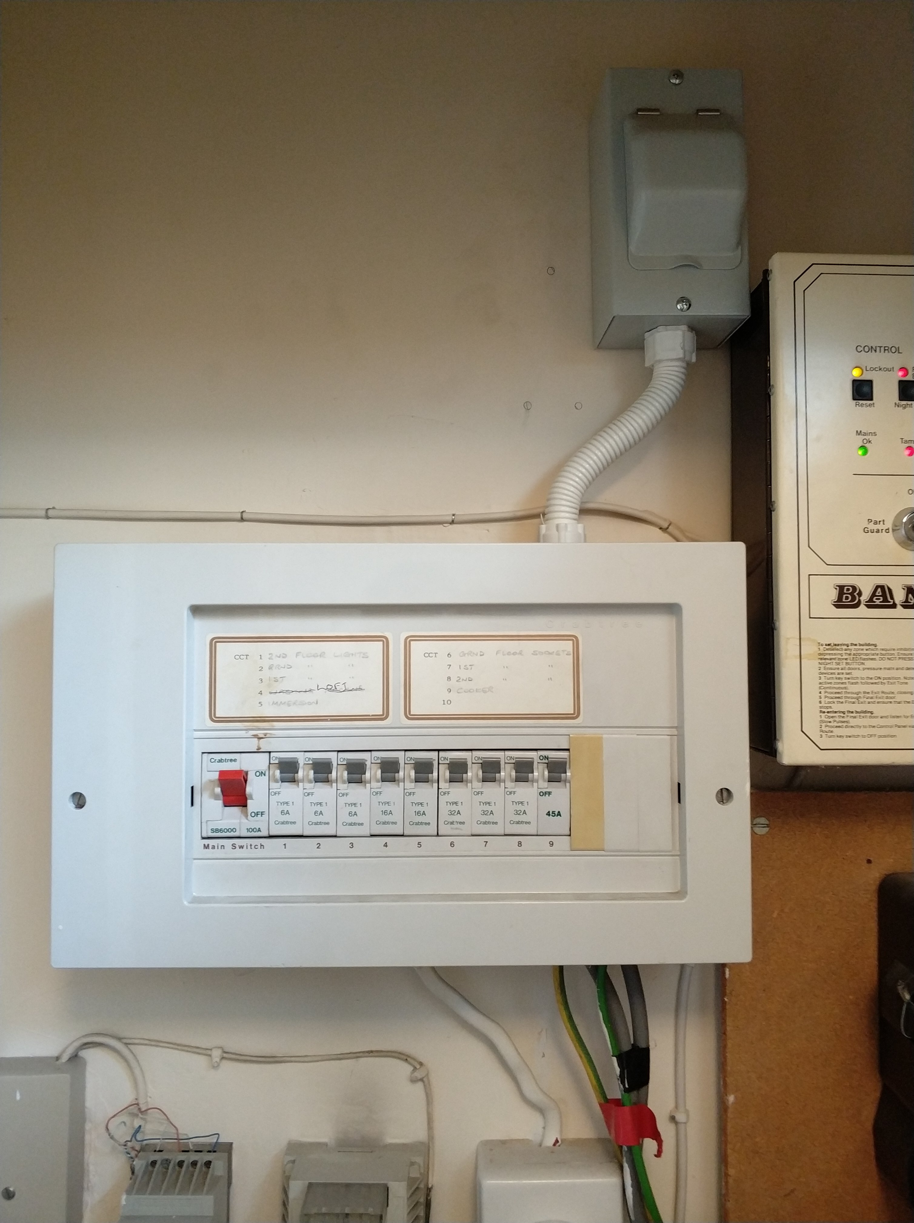

Hi all,
I was asked today to add 2 extra sockets on to an existing kitchen ring, however the board is an old wylex with the push in MCBs so no rcd protection. To add the extra sockets would it require A board change/rcd isolater?
Thanks
You need to add RCD protection where it is required for sockets and possibly buried cables. How you achieve this is up to you and your customer's wishes/budget.
A separate RCD next to the board is a cost saving favourite.

So to do this, would you insert the RCD enclosure between the circuits mcb and 1 of the ring finals legs?
bang one of them in enclosure .

NICEIC tell me I can use plastic enclosure, i queried this in light of the 18th ed, response i got from the NICEIC tech support below
Although we would recommend it, generally any enclosure used solely for an RCD would not fall under BS EN 61439-3 and would therefore not require a non-combustible enclosure.
It is permissible to carry-out additions or alterations to an existing plastic enclosure consumer unit where the designer considers it adequate for the altered circumstances, there are no signs of thermal damage, product recalls and complies with the version of the regulations it was designed and installed to. Any planned change of the consumer unit would require a non-combustible enclosure.
We trust this answers your questions.
Hence why i have used a small plastic enclosure and put a RCD in and had no concerns. it was the most cost effective and simple option of adding RCD protection the the circuit i was working on. Otherwise it would have meant a board change. i was also quite limited in terms of space by the board so a small enclosure did the trick.
