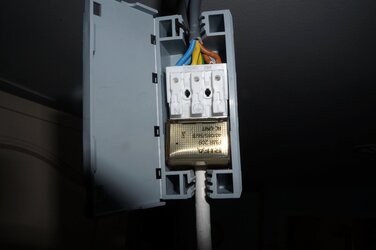

@Lucien Nunes its not a purpose built unit, it's just the normal Wago lighting box and it all fits in neatly, just happenstance really, its what I used to update an existing set of LED GU10 downlight fittings to stop them flashing, I don't know if the number is anything to do with it, but there are twelve of them and I had to put three of these in to achieve the result.
Sure, I meant that you had purpose-built them for the downlighters during installation, but the OP wants to add to existing fittings hence probably easier with longer insulated leads. I can't see the capacitance of yours, I wonder what length of cable is in your switch runs to create the leakage?
