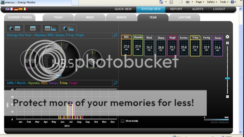

This is our horse race, you might find it intersting. we quite like Yingli as module now! They are 250wp I think and installed at same time and same array.
http://i64.photobucket.com/albums/h197/artymike8/RACE.jpg
now that's a good idea. Are they all nominally the same rated output panels?
They are all 250's as long as I am aware. It has opened a few eyes and as a company we have switched module.
All on same ground mount, so good aspect. The online software promotes data analysis with many ways to compare.
Reactions: 1 person
would the positive tolenece effect the indivual panel, some can be 255w when first installed
Just guessing - they may get a bit of late afternoon shadow first, as the others drop off very rapidly later, our own systems tend to give a very smooth tail off in the evening - any chance of a photo of the array?
Great - really interesting thread here and very useful table thanks..( i like your detailed guide also to each column :)
