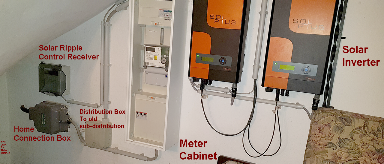

Is it allowed to turn a 1.3" (34mm) thick 4-core (neutral and 3 phase) cable that is 7" (18cm) long, including outer insulation, at the exit from the wall by 90° like a clock hand?
If the insulations are too stiff, I could heat the piece of cable with a hair dryer.
This black cable is certainly very rigid.
It should not be damaged. This is the house connection before the official House Connection Box.
It is forbidden to open the sealed box.
But I want to move the box from 3 o'clock to 6 o'clock, and put all other parts under the stairs.
Away from the wall of this basement vestibule.
Previously, there hung a wrought iron coat rack with mirror.
There's a couch underneath it.
The basement vestibule is not really an "inhabited space", but a living space.
Heating, couch, and in the past, a TV (and perhaps again).
After turning 90° downwards, I can screw the meter cabinet to the wall to the left of the wall from which the black cable comes.
The ripple control receiver for switching off the solar feed into the grid (the grid operator must still pay), then i can then also easily move.
This is the box above the House Connection Box.
The small distribution box between the House Connection Box and the meter cabinet connects the power output of the meter cabinet with the old cable to the old meter cabinet 3m further to the right.
I may want to replace that completely with some thicker cable.
Thanks.
NO you can't safely turn the cable downwards, you will most likely damage it and yourself.
The cable looks like it probably belongs to your Power / Energy supplier, only they could move it.
And depending on the age of the cable your Power supplier may want to install a new cable instead of turning it down.
To be able to safely turn the cable it will need disconecting from the House connection box, so that will mean also disconnecting the power onto that cable from wherever it originates.
When the cable is turned the 4 cores will move inside the cable.
If the cable is turned it will need testing to prove the insulation has not been damaged.

The cable and box are the property of the electricity supply company and their own rules and perhaps your contract with them, if nothing else, almost certainly prohibit anyone but their authorised technicians from altering them. On a practical note, when a large cable is rotated, the conductors tend to slide over each other inside and some try to pull away from the nearest end and others push towards it. If this loosens the connections inside the box, they could overheat under heavy load. If a short-circuit occurs in that cable the arc-flash can be dangerous as the loop impedance is very low and the protection maybe 200-400A fuses in the supply network.
As an electrician in the UK, I would not interfere with this cable and would request any changes to be carried out by network operator.
