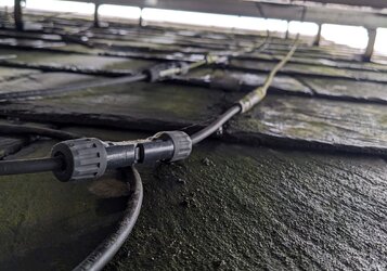

Following my recent zero-Riso issue (unresolved) and also because my system has, in any case, been prone for a good while to the odd 'Low Riso' fault following heavy rain and high winds, I'm going to begin by replacing all the cables and connectors going to my panels. It should be a physically straight-forward task as the panels are on a garage roof, and there's a wide stone wall alongside it from where I can directly prop a roof ladder.

The existing panels have two plugs on them in quick succession - any idea why? Thanks.
It's not very clear in the photo whether the far connectors are the same type. If they're not, the short intermediate cable may be an adapter from one connector type to another. I'm imagining installers don't want to be faffing about making up cables, but just use ready assembled?
PS I know zero about solar panels and their wiring, so afraid I can't help ☹️
Is that acceptable practice in the PV industry? Cables and connectors just lying on the slates of the roof.
I wondered that as well. Looks very amateur, and they must get a lot of abrasion when they move around. I've seen tv coax cables which have been draped across roofs and got damaged due to wear.

The Suntechs came with 'Radox Solar Connectors' attached, and - having began to remove the bottom row of panels - I see that only the two end panels have also had the MC4s fitted on the cables that head off to the inverter. All the rest simply daisy-chain together using the Radoxes. So, not a completely daft install!
The other goods news for me is that I'll only need to remove the bottom row of panels, as this then allows good access to the wires in the top row as they were fitted 'upside-down' with their JB's towards the bottom. So I'll snip off all the old Radoxes and fit MC4s in situ for these, and do the lower row on the ground. I have a tub of silicone grease, too, to wipe over all the rubber seals before assembly.
