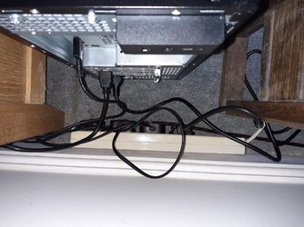

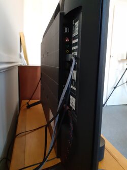

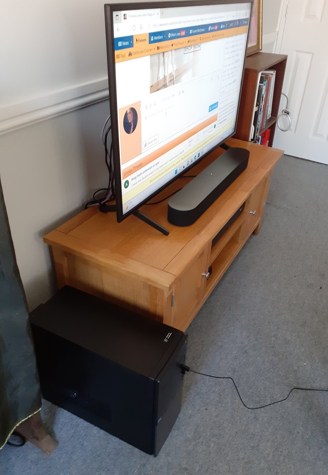

Thanks for the replies everyone. I've attached 3 photos showing the connections if this helps and it shows how far the PC tower is from the TV.
The photo showing the back of the PC and the 4 socket extension lead has plugs connected to the TV, Blu-ray player and speaker bar.
The power leads for the TV and PC will not reach a main socket on the wall so I have to use and extension lead by the way, not sure if that makes much difference?
The HDMI cable that I currently have was one that came with the TV so it's not of high quality. The last one I had was decent but it broke. I can't remember if the problem was happening then also or after I used the cheap HDMI cable. The silver HDMI cable you see plugged into the side of the TV is connected to my Blu-ray player which is of high quality as I thought this may improve image quality when watching films.
What's the connection protocol between PC and TV? HDMI? Yes it's a HDMI cable connected to the TV from the PC.
Has the cable got ferrite beads on it (tubular plastic lumps on the cable behind the plugs!) No there are no ferrite beads on the hdmi cable (I looked up ferrite beads on google so I know what you mean)
Yes I may replace the 4 socket extension lead with a surge protector one like in the amazon link.
I'll try what you have suggested and will let you know.
Many thanks
Jo

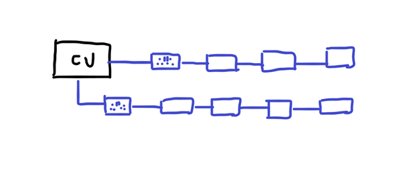

To help me could you:
1. Show me a picture of the consumer unit (fuse box) with its lid open;
2. The circuit breaker switches or fuses should be labelled with their purpose; how many are labelled for 'sockets'?
3. Do the lights noticeably dim briefly when the fridge starts or heater turns on? You may need to swap one led or fluorescent lamp for an older filament lamp which would show the dimming more starkly.
3. If you have two (or more labelled sockets) could you turn one and only one off in turn and then check to see if the fridge and the TV are both without power which would indicate they are on the same socket circuit. Only do this if you have circuit breakers with switch controls. See my electrical art attached which shows two daisy chains of socket each fed by their own fuse/circuit breaker.
4. If they are on the same socket circuit and there is at least one other socket circuit, either relocate your computer and TV near a socket of this other circuit or buy yourself an extension lead and use it to temporarily power the TV and CPU from this other socket circuit. When the fridge or heater turn on does the screen now go blank?
Perhaps best do this step by step if it helps starting with with 1 and 2 above.

Hi lolb72
A quick thought after seeing your photo's.
It would be worth swapping the HDMI cable you are using for the Blu-ray player, for the PC one.
Or as a quick test, just take that lead out of the Blu-ray and put in in the PC, to see it it changes the situation at all.
