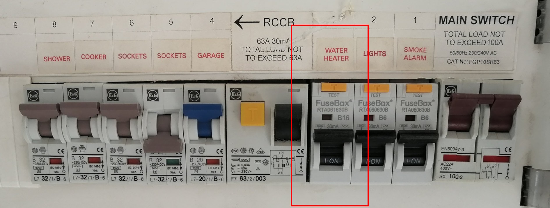

Can I supply my central heating (programmer, two port valves and boiler) via a fused spur taken from the immersion heater circuit?
They’re currently supplied from a fused spur taken off the ring main; however, kitchen wall’s are being moved around.
There is nothing else on the immersion circuit (only the cylinder if boiler fails). The circuit is protected by a RTA061630B RCBO (see pic).

Short answer - yes.
However, you might want to consider what happens if the circuit develops a fault - you'll lose both your boiler and the immersion, meaning the immersion won't be able to give you hot water. That's a fairly unlikely situations unless the cable gets damaged or the RCBO fails - if either the immersion or the boiler&controls develops a fault, as long as both have double pole switching, then the fault can be isolated.
Personally, I'd use a single socket and plug for the boiler. Pulling the plug out is acceptable as a means of isolation, and it means that you can use an extension lead to plug it in somewhere else if needed. However, some heating people still think it's not allowed and you must use an FCU - they are wrong. The guy seemed a bit annoyed when I made him retrieve the socket form the rubbish box and put it back when mother had a new boiler installed.
Can I be first to mention mismatched devices in the consumer unit??
Please do. This CU is from a 2001 build, and according to previous home owner has never been touched. An EICR was carried out less than 6 months ago with no issues. However, I've found a few things that dont follow regs. Anything odd, I'd like to put right.
F&G, I’ve never heard of… fusebox are relatively new, so those rcbo’s have been added in the last few years to give those three circuits rcd protection.
Would have just been mcbs when new, when the regs only required RCDs on sockets.

I've seen them before, but only come across 2 mod RCBOs for them. Doesn't excuse the incompatible products obviously.
Maybe “compatible” just because it fits…. But “untested” according to manufacturers designs.
Very few circuit breakers and similar devices are truly compatible.
Only when one company is taken over by another, and the new company uses the old designs with a new badge…
MEM and Lewden are the only ones that spring to mind.
Even upgraded devices from the same manufacturer may not fit an older type board…. Even though they appear very similar.
The CU is an F&G Concept 2000 (moeller?) fitted in 2001. I now 'suspect' the addition of the RCBOs may now have been carried out during the EICR mid 2022. The wife reminded me that the previous owner showed us some old MCBs that had been replaced recently. So old defunct CU, with additional newish RCBOs. I assume the only workaround is a new CU to be on the safe side?
In practical terms, the main issue is that the cable/busbar entries aren't standardised - while the form factor (overall shape in terms fo DIN rail fitting and opening in the front panel) is. As long as the different devices aren't pulling the busbar in different directions (typically further away or closer to the DIN rail) then there's likely to be no problems at all.
In theory, there could be electromagnetic interference between one of the RCBOs and the adjacent RCD, but personally I think that's unlikely.
What you can see, and which would be more of a concern to me, is that if you look at the main isolator, I suspect the terminals were tightened by a gorilla on steroids. The case of the switch is distorted (the printing doesn't line up across the two case halves of each pole), and it's tilted slightly to the right - so by the time you get the case front on, you end up with the gap above the other devices visible in the photo.
But, if having an EICR done, then the inspector (if they actually inspect rather than make up some test results and fill in the paperwork in the car outside) will flag this up. In a domestic situation, the regs require the use of a type tested distribution board - and since manufacturers aren't in the habit of approving mixes of their own stuff with random competitors, that means using only the devices the manufacturer specifies for that board. My guess would be that the EICR flagged up circuits "not to current standards" due to lack of RCD protection, and the previous owner had these RCBOs fitted to fix that. The EICR should show either non-RCD circuits, or the non-compliant devices.
Some will disagree, but I'd give this a C3 (improvement recommended) which leaves it up to you whether you wish to change it.

I took a look at the report. The summary is satisfactory with no C3. Item 4.18 is N/A, item 4.19 Pass.
Agreed 4.18 No SPD = N/A but surely 4.19 should be N/A too as no sign of an AFDD on the photo of the CU in #1. How can you 'Pass' something that isnt there? and yet omitted the fact that Fusebox RCBO's have been installed in another manufacturers board (see #3).
...surely 4.19 should be N/A too as no sign of an AFDD on the photo of the CU in #1.
I was under the impression that 4.19 was a pass with ref to the three RCBOs that had been fitted. i.e RCD(s) provided for additional protection / requirements - includes RCBOs (411.3.3; 415.1).
