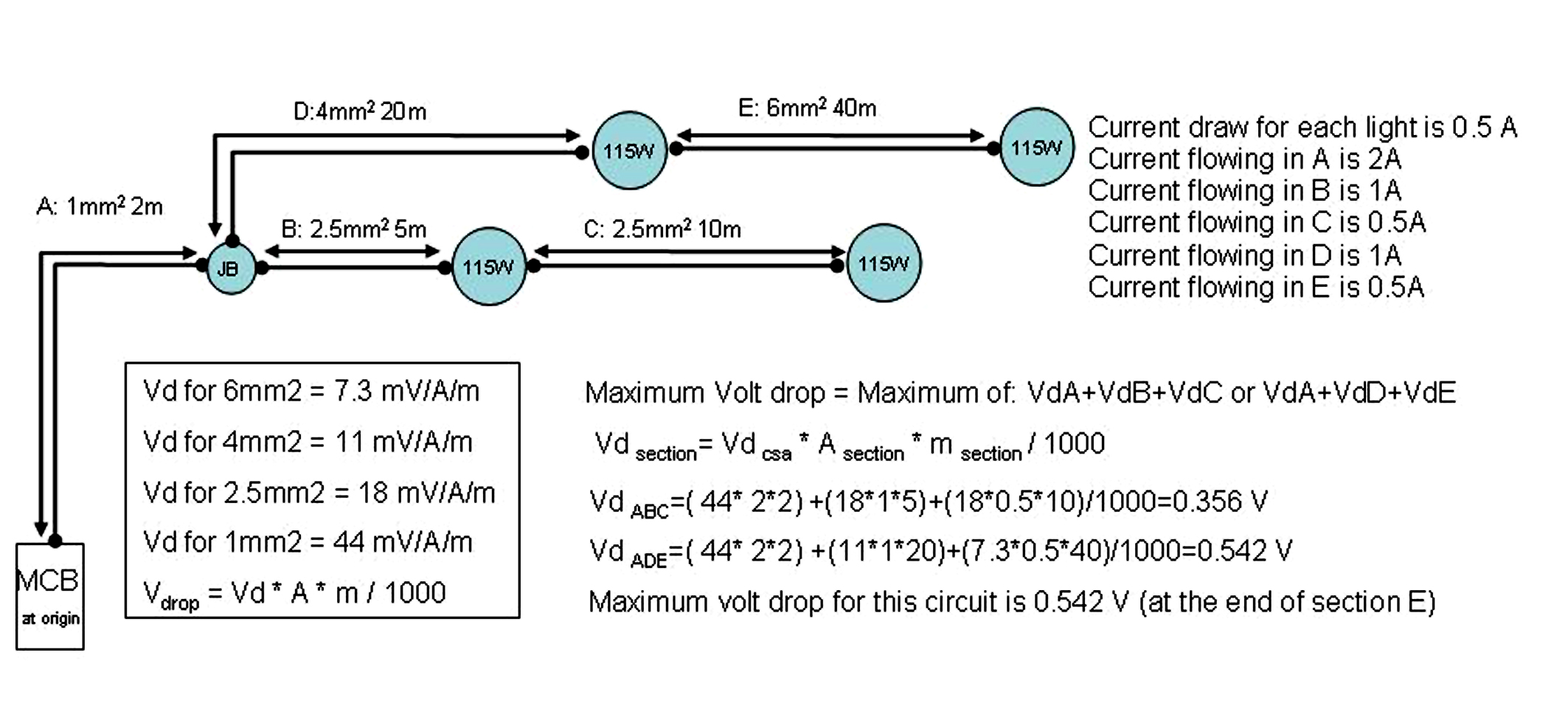

So I am designing a downstairs lighting circuit for a domestic refurb/rewire.
I reckon max demand will never hit 3 amps.
So using the basic formula for voltage drop - (tabulated value x design current x circuit length) please put my mind at ease;
1) When imputing the design current, I can apply diversity to maximum demand first - right?
2) And circuit length - I take this to mean the total amount of cable used, not just the furthest point - right?
Could make a difference as to whether to use 1mm or 1.5mm.
Thanks in advance!
