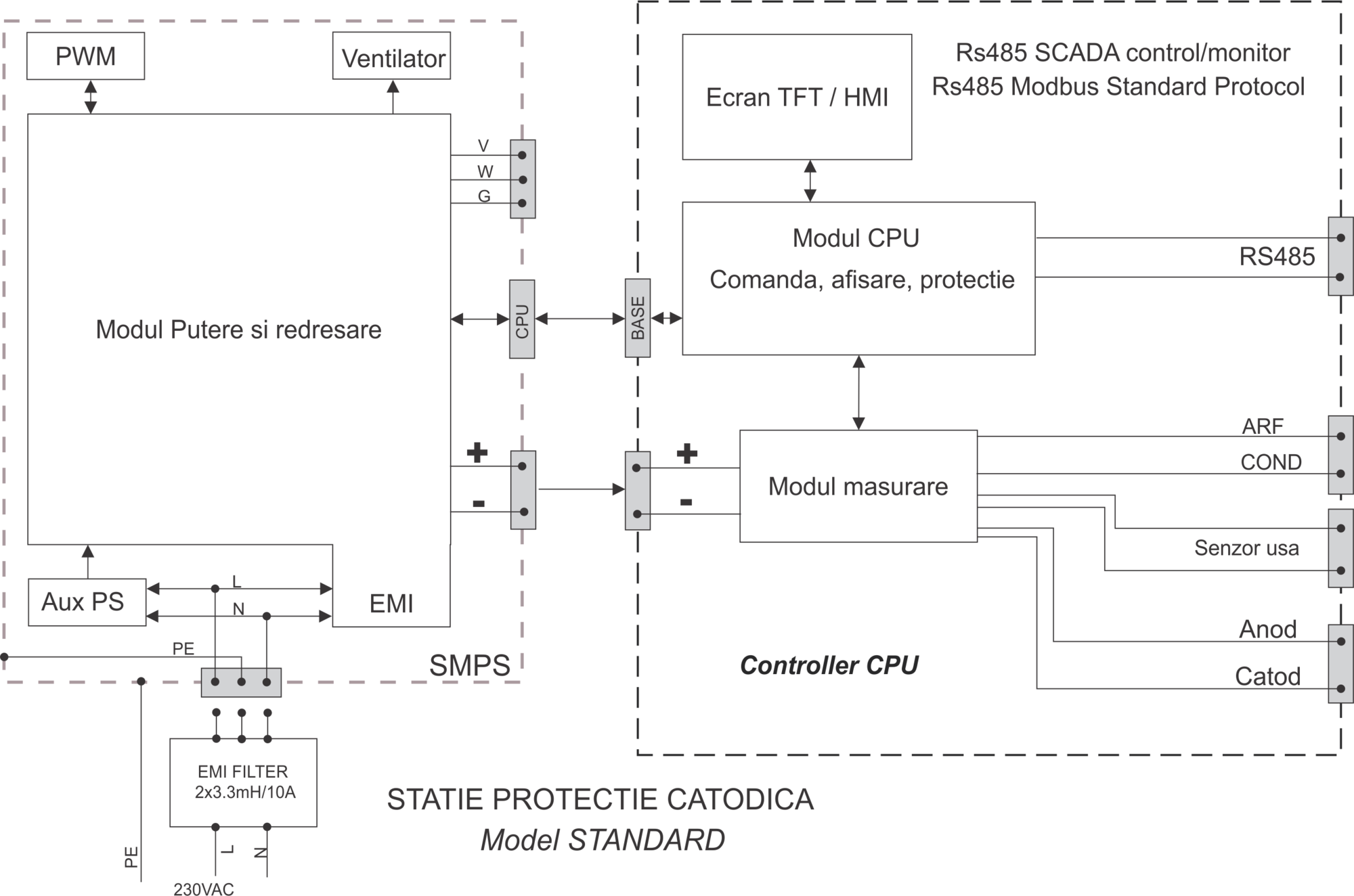

Cathodic Protection Station with Switching Power Supply for Buried Metal Structures
Benefits of the Switchmode Cathodic Protection Rectifier:
  • Can be installed in any existing CP (Cathodic Protection) cabinet.
  • Optional integrated remote monitoring (data transmission).
  • Increased output efficiency, over 90% compared to conventional transformers.
  • Improved efficiency means less heat and greater thermodynamic stability, especially in hot environments.
  • Smaller and lighter in size than the conventional transformer rectifier counterpart, resulting in lower transportation and maintenance costs.
  • High-quality DC output significantly enhances cathodic protection performance.
  • Reduced carbon footprint.
  • Lower AC current consumption.
  • Less copper usage to reduce costs, weight, and theft.
  • Characteristics
    Power Supply Voltage - 230 VAC, 50Hz
  • Dimensions - 220 x 152 x 105 mm (L x W x H)
  • Weight - 3.1 kg
  • Ventilation - Forced with fans
  • Consumed Current - 3A
  • Switching Frequency - 40KHz
  • Nominal Output Voltage - 0 - 30V, stabilized
  • Nominal Output Current - 0 - 20A,
  • continuous Humidity - 85% without condensation
  • Ambient Temperature - 0°C to +35°C
  • Efficiency - 94% Protection Class - IP20
    • Controller
    • Internal Protection - OVP/OCP/OTP
    • Display - TFT color 320x240/2.8”
    • Displayed Parameters - Current / Voltage / Potential ON/ Potential OFF/Operating Temperature / RAS / POW/PU
    • Status Display - PWG/OVP/OCP/OTP Control - Manual (via potentiometer) / Automatic (PID) / Dispatcher
    • Operating Modes Display - MAN/AUTO/DSP/SAFE Communication Port - RS485 protocol - Industrial Modbus
    • STATUS
  • PWG - Normal Operation
    OVP - Overvoltage Protection
    OCP - Overcurrent Protection
    OTP - Overtemperature Protection
    RAS - Sacrificial Anode Electrical Resistance
    POW - Output Power (watts)
    MAN - Manual Control
    AUTO - Automatic Control (PID)
    DSP - Dispatcher Control
    SAFE - Safe Mode Operation
