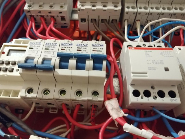

Been difficult to find suitable contactors at a reasonable price. Found some 4 pole contactors. Shouldn't be any issue swapping 2 x 2 pole contactors for 1 x 4 pole should it? 2 live and 2 neutral inputs and outputs. Each 2 pole is only drawing about 10 amps. The 4 pole is a a 40amp.

I believe it is the same one as this:
Many thanks
Was going to leave it for this year but the buzzing from the downstairs is really quite annoying now as we have the heating on more frequently as winter is approaching here in the Southern Hemisphere.
I cannot read the make - what is it?
At first blush they look rather cheap and cheerful. Here is a proposal: I will send you some ABB silent relays and perhaps you will make a donation to a children's charity in Uruguay akin to the UK's NSPCC - what say you?

I understand. I will do some research tomorrow morning over a coffee. At 10 A and rated at 40 A they are most likely suitable - but I thought you wanted quiet contactors(*)
I, and maybe many others, have a bit of a downer on Chinese products at the moment if that is where this contactor is from. I find Italian made stuff good value - but then I have Italian ancestry with the surname 'Solari' - so I may be biased ;-)
* - We could try to be clever and put good but noisy contactors inside soundproofed enclosures? I'll have a look at materials and ways to attenuate the annoying hum. At first pass I wonder about some lead and rubber combination.
Yes I would prefer fairly quiet contactors. Not sure how much noise these would make tbh.
One out of the 3 downstairs is really buzzing loudly (the buzzing varies from day to day, from quite loud to a sound like its vibrating out of the module box), obviously not very well.
As you know the one upstairs is a 4 pole ABB and you cannot hear it at all. Super silent.
I have asked the supplier how much noise they produce.
Update: He's just replied and said they are not quiet.

Just purchased 3 of them. Got some 4mm wiring also to replace the 2 x 2mm wiring.
One of the 3 old ones was vibrating so much this morning I had to turn it off as my son was having a zoom school class and was interfering with his class! (home schooling still continuing here in Uruguay)
Arrived and all installed. Nice and quiet finally. Switch quietly and silent. Brilliant. Thanks for all your help

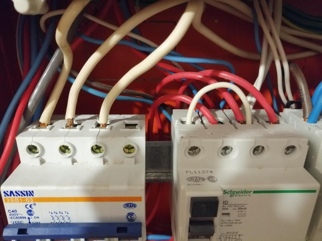

Just revisiting this topic. Everything is running fine but had a doubt about the type of phase we have. The utility company changed our meter this week with a new smart meter after we had an issue with our bills after using the UFH (the clock was 4 hours out on the old meter so the cheap rates before 5pm were being calculated incorrectly!!)
From what I understood the 3 phase power set ups have 4 cables entering but single phase have only 3 (L1, L2, N).
You mentioned it was a 3 phase initially. Was it decided that this was a single phase in the end with L1, L2 and N?
Many thanks
Your supply is 'three phase 2 wire corner grounded delta' as in the diagram above but your line voltage is 225V (ish) instead of the 480V this diagram shows.
So in your home A is L1 and C is L2 and B is the earthed phase/line/neutral N.
Single phase supplies are derived by connecting between pairs of lines A-B, A-C and B-C.
Your UFH uses all these pairings to 'spread' the loading over the three lines/phases since this is a large long duration power demand and makes best use of capacity of the three lines to your home.
I did not delve into how all your other home final circuits are wired eg: lighting and sockets but I strongly suspect they are connected A-B thus L1-N, and B-C thus L2-N so that single pole switching may be used in the line/phase only because only L1 and L2 are at 225V wrt to N and E.... and N is at a low voltage wrt to E - I think we measured 20V ish.
When L1 and L2 are used the switching must be double pole as you have gathered from the contactor contacts wiring for the UFH because both lines are at 225V wrt to N and E.
