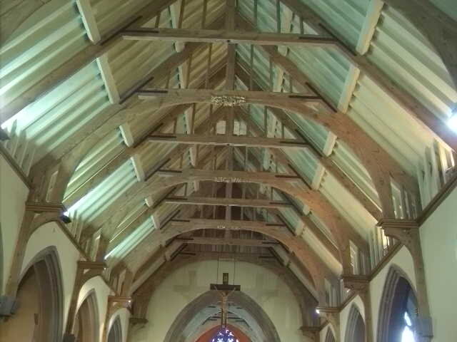

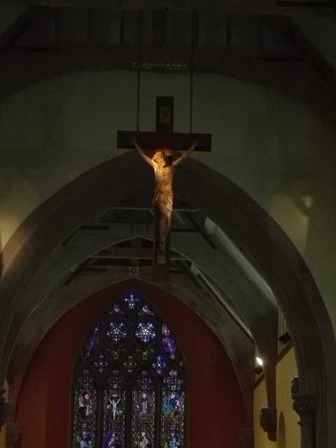

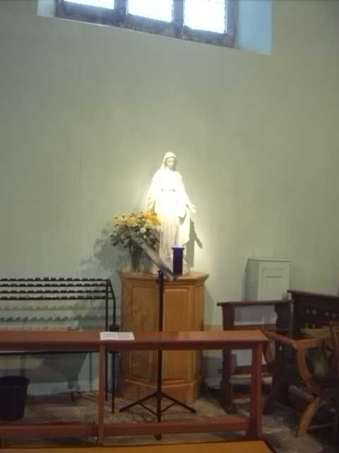

here's a few pics of the replacement church lighting i did in one half halogen the other half LED we changed the old halogen 150 watt up lighters to 30 watt LED and changed the 12 volt 50 halogen to .. to light up the crusifix and mary ,not telling you what fittings i used for that so its have a guess time see if you know what it is lol st james church 030.JPGst james church 033.JPGst james church 031.JPG the light fittings are mounted high level uplighters are 6 meters high
