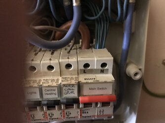

Could well be. Is this direct from the meter or sub main?
Yes, will be split concentric.
Yup, deffo split con cable. You could maybe fail the termination into the MCB clamp, it's usually against manufacturers recommendations having so many wires in it, should really be using a palm lug or similar.
