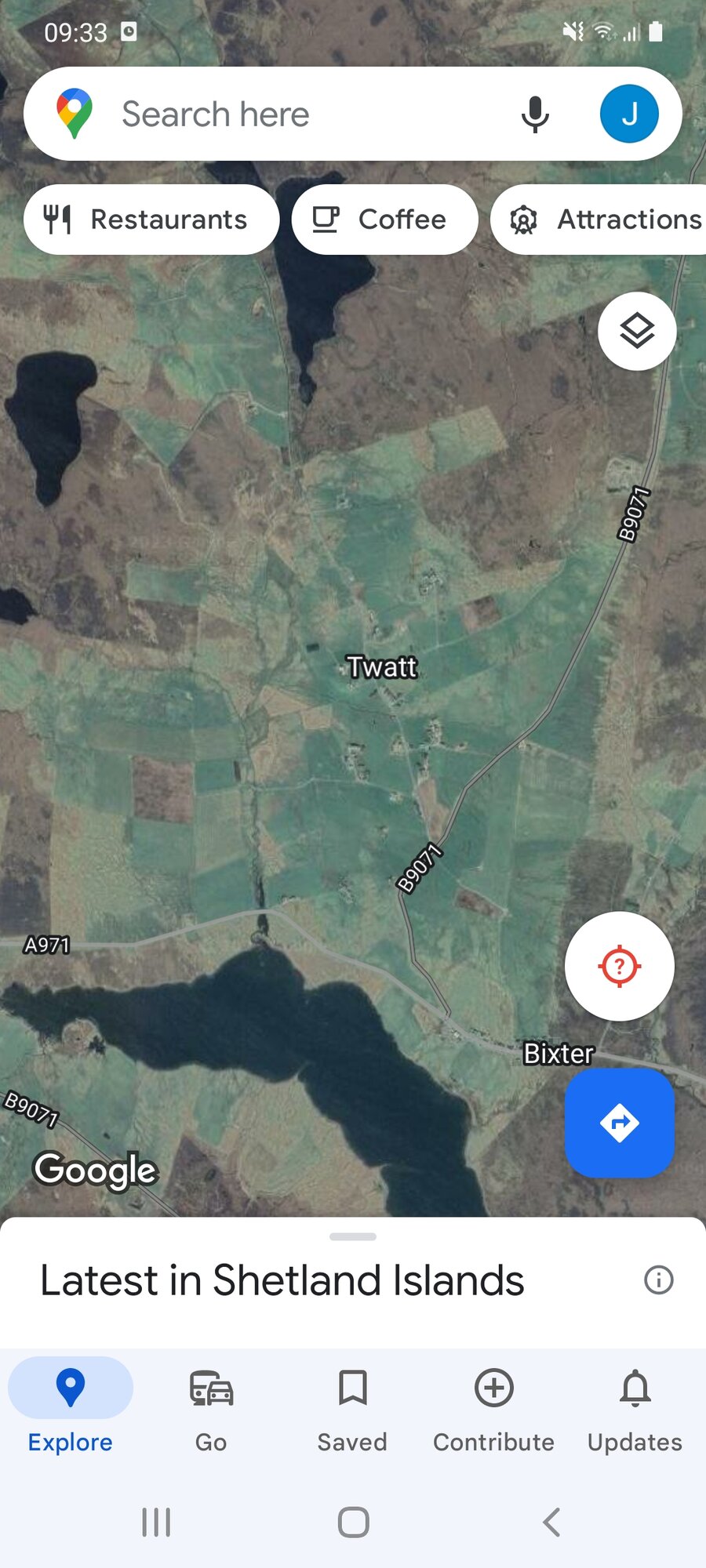

EDIT
I don't know why it keeps removing the village name, I know it sounds like a rude word, but it's just the name of the village!!!! - It's not even spelt the same!
Here's the location:Consumer unit in cupboard in Shower Room Screenshot_20230205-093345_Maps - EletriciansForums.net
Here's the location:View attachment 105906
haha, yea i cant understand why it's removing that name, weird, lots of funny place names in Shetland and all the islands, i do a bit of diving as well, mostly for scallops, or around boats in harbours etc.
