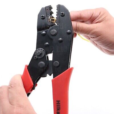

Crimping is quick and very reliable (more so than screw connections) if you use the correct tool. By time you bought the cheap and useless crimp tool, a soldering iron, solder, and practised soldering and not burning your fingers, you could probably have bought something like this for US $12.79:

The problems with the plier type crimpers that many places sell is that they simply don't work. People sell them because people will buy them, not because they are any good :rolleyes: And people will buy them because they are labelled as "crimp tool" and they are cheap.
The main reason they don't work is that they do not properly squash the terminal down. A "decent" crimp will close the hole in such that the strands are subject to pressure from all around - done right the pressure is so high that the joint is "gas tight" (oxygen can't get in and corrode the faces of the metal). If you look at the ratchet tools people have been pointing you to, they constrain the sides of the terminal so it can't spread, and thus they close up the hole nicely.
These cheap pliers simply squash the terminal hole into an oval - leaving the strands free to migrate outwards with limited pressure on the faces that do meet. This is compounded by ---- poor geometry that means anyone less than an 800lb gorilla will not get anything like the pressure needed to create anything resembling a crimped connection. I do have a pair in my box (that I bought maaaaany years ago before I knew better), they don't get used for crimping terminals - actually they rarely come out at all and just live in a box of terminals as I'd gain nothing by throwing them out of it.

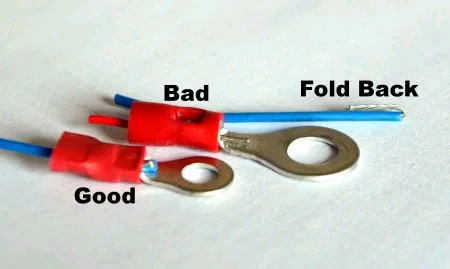

I tried to crimp this small wire into but connector 1.5 mm, but wire is too small and I can't crimp it good. I don't know what the size of wire is.
What should I do with the wire, should I fold it back down the wire insulation and crimp all of it?
Can't you get a smaller butt crimp?
