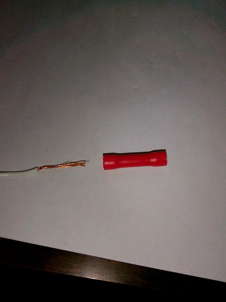

I tried to crimp this small wire into but connector 1.5 mm, but wire is too small and I can't crimp it good. I don't know what the size of wire is.
What should I do with the wire, should I fold it back down the wire insulation and crimp all of it?
Can't you get a smaller butt crimp?
