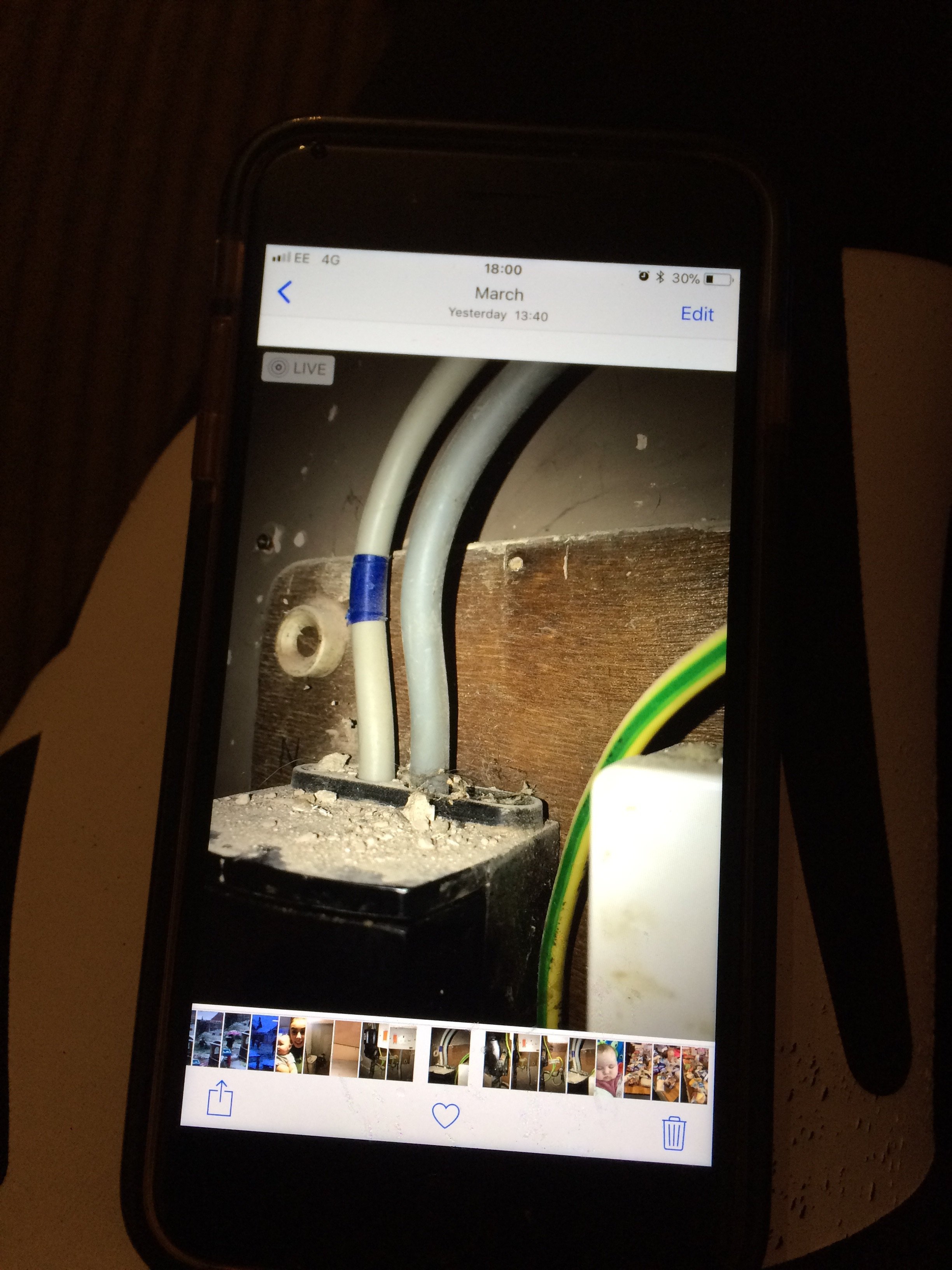

hello!
Just looking for some advise,
Basically we had an electrician fitting a new shower and lights yesterday, he tested a light socket before touching it (after turning all fuses off) and it was live... come to realisation an electrician working on behalf of an energy supplier had fitted the smartmeeter into the mains the wrong way round (crossed polarity?!) and all the sockets, light switches and light fittings were the same downstairs.
The electrician shut our electricity down straight away and told us we weren’t to turn anything on until the contractor came out to fix it as he couldn’t touch it, he said he’s amazed the house didn’t burn down (they came out, done reports, took photos 12 hours later with two children under 2 in the house) at 11pm
I’m just wondering how bad this is and where do we stand?
Obviously not getting much info from the energy suppliers and just wanted to know the best course of action
Thank you

Got any pictures you can post?
If it's a modern consumer unit, the main switch will be double pole. So switching this off will have cut power across both live and neutral.
This is the only photo I could take before the contractor electrician came out again, of the mains unit, my electrician said it has no seals on it either from the man who fitted the smartmeter

I take it from your initial post that your energy supplier (DNO) fitted your smart meter.
The "Electrician" who came to fit your new shower and located the reversed polarity of your new meter installation, should, in my opinion informed you immediately, and recommend you contact your DNO right away.
There was no need to switch your CU off, for the reason Rob has given, if the Reversed Polarity is infact the correct assumption, then your DNO want's a good kicking. Take this issue further if the installation of the meter was incorrect.
Hi - polarity is a basic test that should have been done by your meter installation person. Perhaps your Electrician was surprised to find it and was thinking "if they've got that wrong, what else?".

Also, it was a bit of a mess as our electrician couldn’t touch anything the contractor had done so I think he shut the power off just for safety until they could come to rectify the problem

Yes he said he’s never seen it before so turned the power off just in case. He also said he should’ve done the polarity test both before and after installing the meter, so thank you for making things a little clearer

Partner has just had a telephone call from supplier..
A full investigation is going to take place into the contracting company and 60 of his jobs before and after our house, the HSE has been informed, ofcom(?) & trading standards so I guess it looked to be serious
