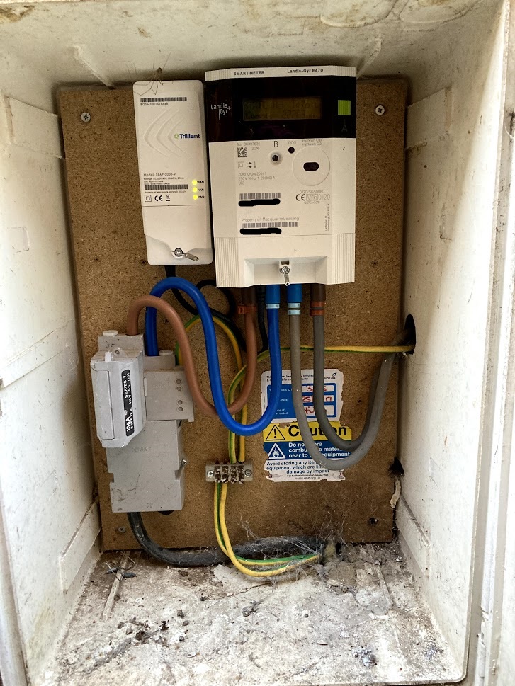

Hi everyone,
I'm still training so some advice would be appreciated :)
We have a shed about 60m from the house where would like a supply. I've already ran some 2 core 4mm SWA and wired up a CU with a 30mA incomer, it will be protected upstream by a 16A MCB. I went for 2 core because I want the shed on TT becuase of the length of cable run, we're on PME.
Our main CU in the house is fed by SWA from an 100A switchfuse located externally in seperate enclosure to the meter. I don't want to run the shed feed from the main CU because it would be too disruptive to run internally.
We're having some building work done at the moment so I was having a chat with the builder's sparky and he was saying he could put a small 4-way CU in the main meter box, since there isn't enough space in the other one with the switchfuse. He's going for a 4-way just incase we want an EV charger in the future.
Is this permissible? I was under the impression that only the DNO and metering equipment should be in the meter box. His plan was to just use a set of henley's and split the tails which I'm fine with, but shouldn't the whole installation have a single point of isolation?
I suggested using a Wylex REC4 and linking out the incoming terminals with busbar to allow two sets of tails to connect on the outgoing side but he wasn't too keen on that. Getting a REC2 and henley to fit along with the CU would be a bit of a squeeze.
Any advice would be appreciated, cheers

Is there room to fit a 100A isolator just after the meter, instead of Henley blocks, and wire both CU from this?

Can you post a photo of the meter box to show us the layout?
What about the switch-fuse box, what sort of space is in there?
Here is the meter box and switchfuse box. Plan was to move meter and comms hub to the left, then CU would be next to it. Isolator/henleys below it next to the cut out.
The FCU next to the fuseswitch is just for outdoor socket spurred off the downstairs ringmain.
An 100A isolator would fit fine minus the henleys, but the REC2 only has two poles, and the sparky wasn't keen on linking out a REC4 with busbar to give it two holes for each pole. I suppose I could do it myself, nothing better than learning on the job! Just wondering in that case if there is a reason to not link out a REC4 with busbar? Obviously Wylex haven't manufactured with that in mind, but I can't see how it would be unsafe...
Being perfectly honest you don't have any usable space there for a mini-CU to be added.
The best I would try given that space would be to look at replacing the fused-switch with a mini-CU that had something like a 63A C-curve MCB to feed the house and something a bit smaller for your 4mm cable (or whatever you select).
That is not a great suggestion by any means, as will have quite poor selectivity between cascaded MCB, but it would allow something to fit and some garage CU are tolerably protected for non-domestic environments.
Maybe something like this with the supplied MCBs replaced:
But obviously there are more things to check before proceeding, like if that has a 100A busbar, if the house demand is going to fit a 63A feed limit, etc.

That is a good point actually. The type B MCBs in the house CU would trip well before the C type, well at least in theory. I could get away with a 63A but would prefer an 80A, although it looks like you can only get 80A MCBs in a 27mm width, which hopefully would not foul the busbar.
The only issue I would have with replacing the switchfuse with a CU is the neutral for the 25mm swa wouldn't fit nicely in the neutral bar, meaning I'd have to split it between two terminals which would look a bit naff, but functionally wouldn't affect it I suppose...
Type B will not necessarily trip before a type C, MCB's often done discriminate at all.
You won't get an 80A MCB to fit a domestic CU.
Don't split the neutral between multiple terminals, fit a reducing lug.
You get selectivity only to the instantaneous trip point of the upstream MCB, in the case of 63A C that is about 500A RMS fault current, for a 63A D it is about 760A (using Schneider's on-line tool) so not very good by any means.
As davesparks says you won't get a matching 80A breaker for a garage CU.
I have not looked at the sizes for a three-phase switch-fuse, as you might be able to parallel two of the feed fuses for L (more reliably than with a 4-pole isolator) and fit a link on the 3rd pole to switch N, thus have both a fuse for the house CU and a different one for the garage CU and so better selectivity than cascaded MCBs.
Gives you fuses and DP switching, just no independance of house and garage CU should you need to work on one feed cable.

A quick check shows most TPN fused-switches are significantly larger than I suspect you have space for, of the order of (H)400 mm x (W)300 mm.
[automerge]1590479269[/automerge]
Seems MCG do a 63A D-curve MCB, that might be your best bet for any tolerable selectivity given the space constraint:

Looks like you’re right regarding the TPN fuse-switches, some would fit but would leave no space for the SWA to exit. I will go for the CU in that case.
63A would be adequate, considering we don’t have an induction hob, electric shower or an EV charger on the main CU. The only time we’d approach 63A is if our heating fails and we have fan heaters going. What I can do is fit a socket in the lounge (other side of the meter box) off a 16A MCB from this new CU which would could be used for heaters etc.
Thanks all for your advice, much appreciated
If you can do that, why can't you run the new SWA in to the current CU?
It would need to be an RCD socket as this supply has no RCD protection. And no, do not put a 30mA RCD in there in place of the main switch of any new fuse-switch replacement as that is very likely to have spurious trips!
