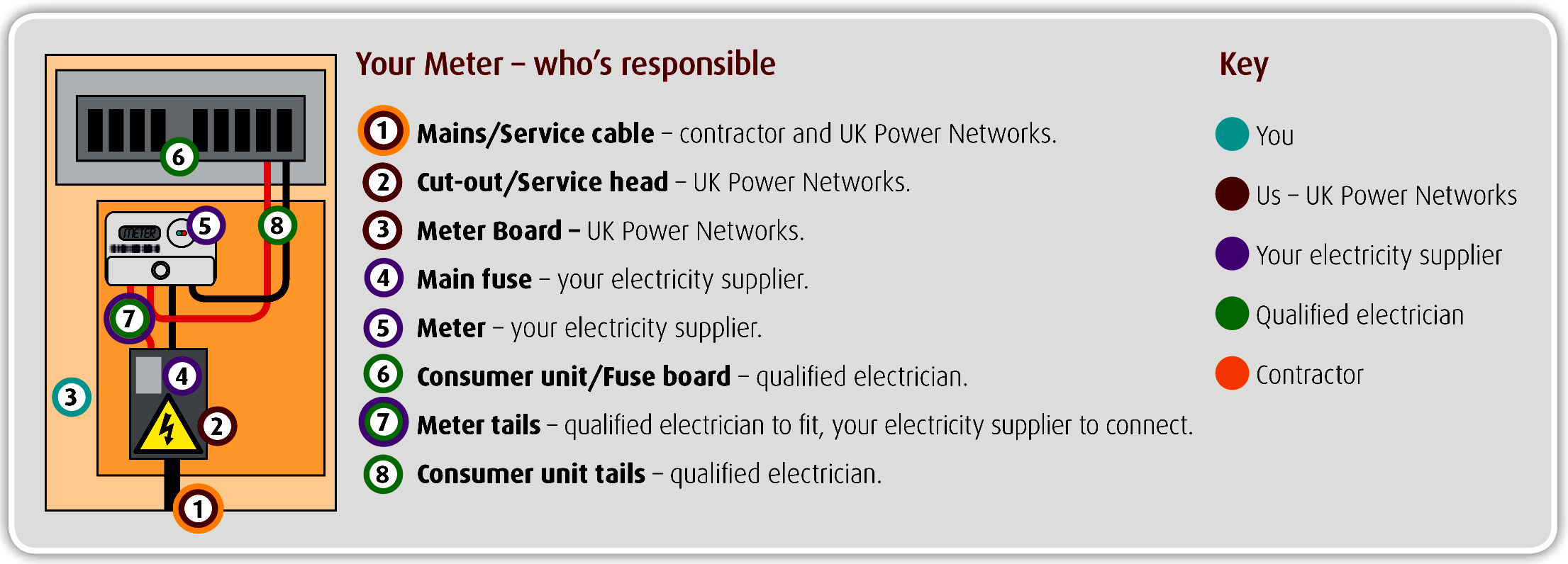

The situation there is somewhat confused but it looks like your service cable to the property, before the service head (the main fuse), has a looped supply i.e. it feeds your place and somewhere else downstairs.
This is very unsafely arranged in taped over Henley blocks partially within a joint box.
This is before your service head and before your meter and is part of the service cable to installation.
This is without doubt the responsibility of the Distribution network operator, although they will almost certainly state that someone else has worked on it it is not safe and is not sealed.
The attached diagram shows the areas of responsibility for parts of the installation.
The joint box and cable that you have there are positioned at the point labelled 1 in the diagram.

Ahh, just seen your post, you are supplied from the shop downstairs and if that is a secondary cutout then the meter beyond it must be a check meter rather than a electricity supplier meter and you would pay the shop for electricity rather than having a bill from the electricity supplier.
If this is the case then the service head above the open black box is just a remnant of a previous supply and the cable from the shop is the responsibility of an electrician, however the electrician would need to know and be shown the connections in the shop to be able to work on this without danger of electric shock or prosecution.
Just looking at the mess you have in the photo any electrician would say they cannot work on that part of the supply.
If they know it is a sub main from the shop then they may well be able to work on it.

Being before the meter it IS the responsibility of the DNO in your case UKPN.
Ring them on 115 and tell them you have exposed live conductors BEFORE your meter and quote them code A04.
They have a duty to attend within 3 hours to rectify the problem which would probably involve replacing the sub main with split concentric and fitting a red link for local isolation.
