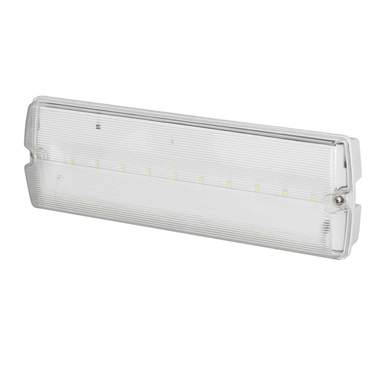

Finally it raises a useful point, he might want to fit some sort of emergency lighting so if the power fails for any reason he is not in a dark and dangerous workshop trying to get out past various cutting tools!
Not too expensive and potentially a great feature, for example:
