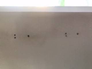

I can only see the damage through the holes I have drilled. ( didn’t mention that I was putting up 2 shelves and it’s hit the cable twice
Top and bottom shelf one has caught the edge and the other has gone through the middle

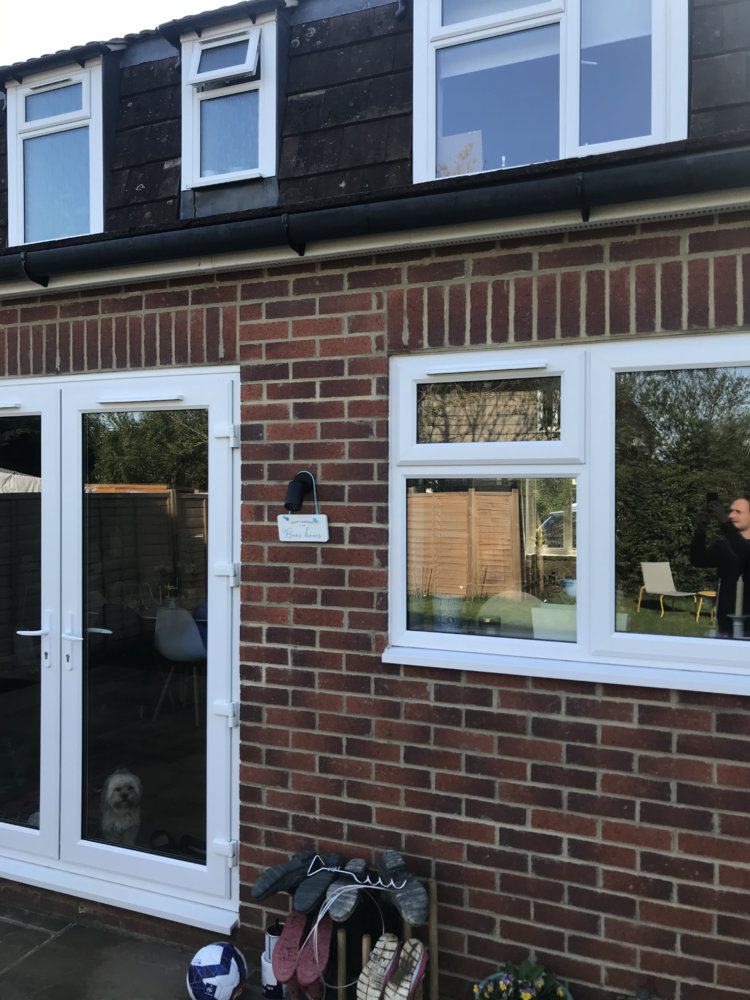

here’s the inside and outside view of the wall
Just noticed the plug for the dishwasher is inline with the holes vertically

Looking at the photos, there is an upstairs room?
Still might be possible to lift a board, and pull cable out.
Unless you’ve drilled right through and severed the cable. Then you’ll have a bit stuck in there, so digging out is only option.
At first I thought the outside photo is of two storeys, but looking again, I can see guttering half way up the wall, so the extension must be single storey with a flat roof.
Just possibly a (re-fillable) hole in the ceiling will give access to the cable(s) and they'd be loose e.g. under capping or in oval conduit, or even loose under dot/dab plasterboard. Or the cable(s) could be firmly encased in a bonding coat of plaster, having been clipped to the wall.
Would help to know the wall construction and cable installation method before making any holes anywhere.
