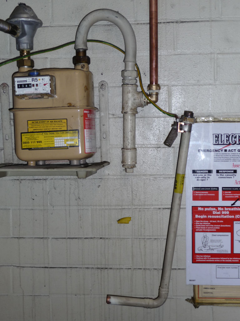

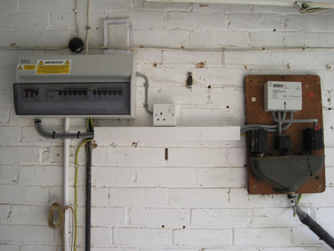

Now that we've seen some prity diagrams (am I starting to sound like a teacher lol) we will now look at real world photos that are not as straight forward as the diagrams.
First example, is it a TN-S or a TN-C-S or both?
It's a semi-detached house with a pre-paid meter and cut out within the same enclosure (I think!).
The property is some distance from me so I'll ask the client (a friend) for another picture showing the content of the enclosure and when I get it I'll post it here.

The incoming cable looks like a split concentric and so will be TN-S. I assume that the G/Y earth cable is the main earth to the remote CU. If in doubt test for TNC-S!!
Though it might be that. Don't assume it's 415V because it says it on the side. In a similar way, don't assume it's a 100 amp fuse because it says 100A on the fuse carrier. Daz
Yeh, sorry, my system went a bit lala for a few minutes. I don't assume anything. Assumptions bite! But point taken...
Right you are, not to assume.
After obtaining some temporary seals from the DNO I looked inside the carrier and this is what I found.
Brush
30 Amp
60 LR
Certified
440V AC 4
BS88 - 1952
Class 3
Made in England
The print on the fuse had faded so there may be errors in the above info.
The DNO were contacted again and they're sending an engineer to address the issue.

Anyway, can anyone identify its breaking capacity?
I always put in 33kA... For main fuse.
