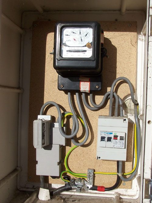

these are TN-S systems

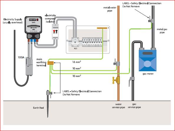

TT system this system is when the installation has not been provided with a earth terminal by the supply company so you have to put a earth spike into the soil and make your own earth path this is most commonly used in rural areas but i have seen this system in a few of the houses that i have been in
TT system

Ok so what is earth system then?
Just thought I'd throw a curve ball at you mate.
Ps good thread.
not 100 percent sure to be honest i would say its a TN-S but cant really see the pic properly haha
Load up the picture and look at it full screen and then tell me what you think??? :wink:
You may come across this once in a blue moon but it is worth knowing and the reason why it is like this. :)
the pixel is only low so it just distorts when i look at it full or try and zoom in but to be honest it looks like it is a tn-s and a tn-c-s it looks like the main incomer has a bonding conductor attached like a tn-s then from the isolator to the meter it looks like tn-cs
Yes you are correct, its both. Reason being is that the DNO were changing all the houses on the street to PME and did the connections in the homes first (of course) then the sub station so in the mean time each house had both. That was fun testing it lol. I had to put down a Ze1 and a Ze2 for the first ever time.
