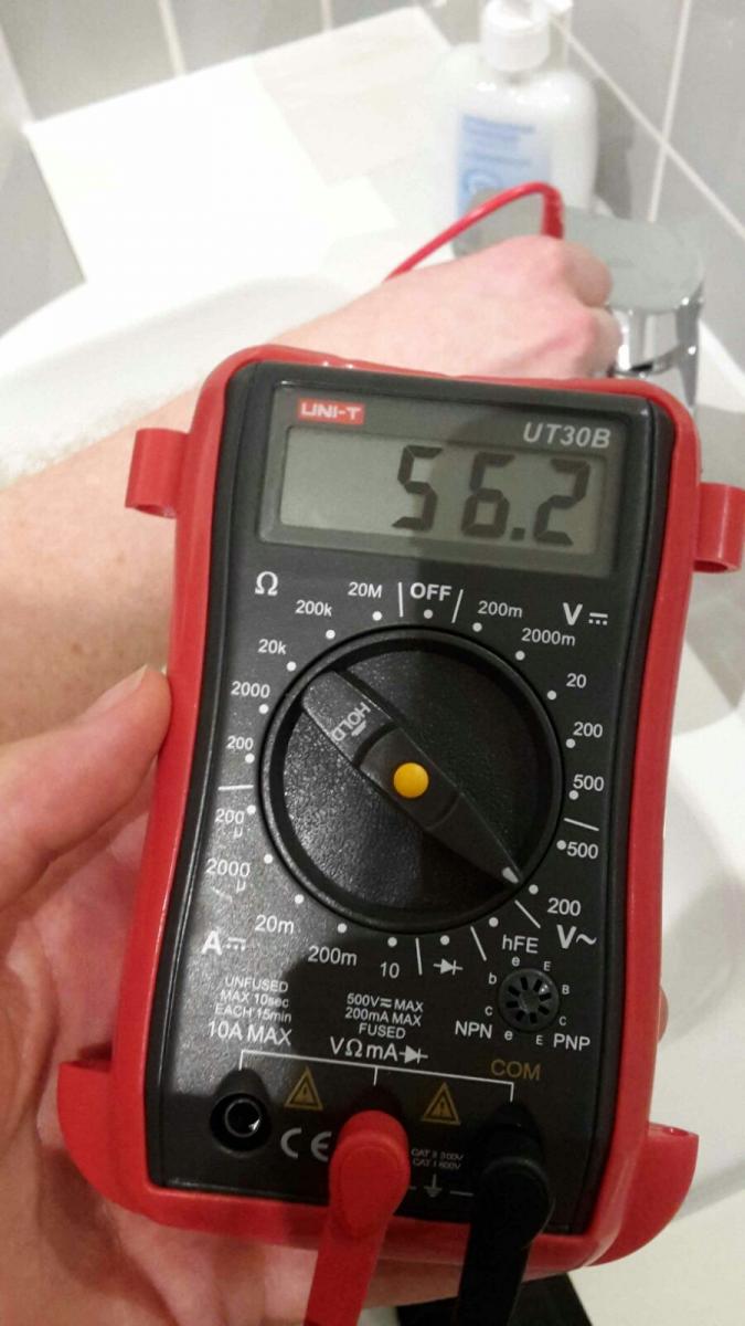

Despite now being a boring old accountant these days, my first degree was in Physics so I went into detective mode and dug an old multi-meter out of the back of our car we used when we were trying to work out why our car wouldn't start (alternator failed!) and started poking things.
The only metal thing nearby was the main mixer tap. I opened up the cupboard under the sink and pawed around till I felt the little metal grounding strip thing so I figured it made a pretty good ground and started poking things.
I detected no DC current and no appreciable DC voltage. HOWEVER, on V AC mode, I detected a bias of 50 volts AC., even when it was switched off on the plug. It only dropped to zero (actually like 1-2v AC, but figured that was probably just noise on my crappy old multimeter) when I flipped the 'radiator' circuit off the main fusebox.

If you're getting tingling sensations from appliances or things that are plugged in then there's actually 2 separate faults that need to be found. Firstly there's a breakdown in the insulation somewhere that's allowing current to 'leak' from the circuit and secondly there's an inadequate earth that's allowing the voltage of the chassis of the item to rise. Both faults must be found and repaired before the installation is safe. Unfortunately your cheap tester isn't going to find them, you're going to have to get in an experienced electrician.

The tester you're using isn't going to give you meaningful touch-voltage readings due to its enormously high input impedance. Whilst it will give you an indication of a voltage present it's not the right tester for the job to give an accurate reading of this type of voltage.

RCD's are pretty sensitive and if the voltage on your towel rail was actually 50v or more then it should be tripping if you touch it and feel a tingle or shock. Ramp testing the RCD is another test than needs doing when the sparkies come.

It could be a fault with the element in the radiator, but needs testing properly to determine this.
Usually these types of electrically heated radiators have an immersion element that is inserted in where one of the valves sits. Sometimes these rads come unfilled and if it was connected and then turned on without any fluid inside, the element could have been damaged. Alternatively if the radiator supply circuit was IR tested at 500v between just L&N whilst switched on this can also damage the element. I've experienced both these scenarios in the past which have caused failure or leakage faults.
But you should get the supply circuit checked out also, as Marv mentioned the worrying part is making sure you are adequately protected against electric shock, i.e make sure its installed correctly and using the correct equipment.
I'd insist on having a qualified electrician in to check it out!
I recently investigated a client getting tingling from touching an extractor fan. It turns out that somewhere along the line the earth had been lost. The tingling was from either induced current, or earth leakage current, which had nowhere to go making the extractor fan framework live with about 55Volts AC. Restoring the earth in the cable corrected the problem.
