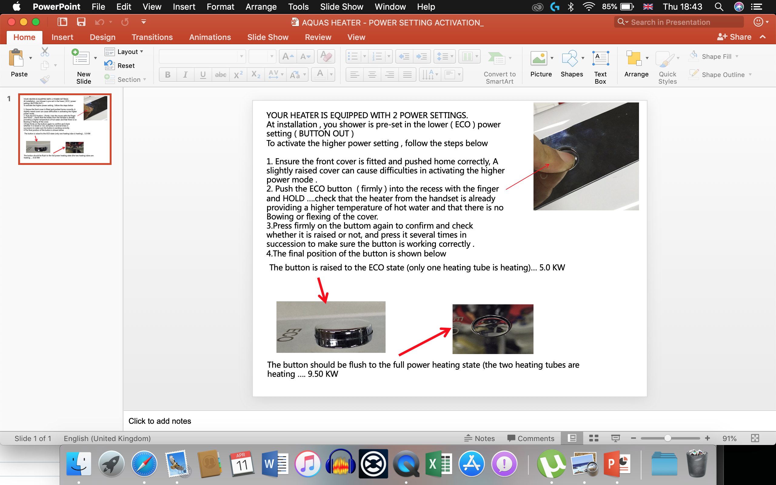

Fitted 9.5 kw aquas aquamax shower today (customer supplied) and new full rcbo consumer unit, all good except the shower is absolute s£&t! Even on the highest setting the water is only moderately hot, water pressure seems fine and no different to any other showers I’ve fitted, one thing I did notice was when I clamped the meter tails with the shower running on full heat it only ever pulls approximately 15amps,new 10mm cable run in void under the floor for approx 18mtrs to a chase in the wall upto isolation switch with pvc wall panels over that,plenty of free air around the cable,admittedly I’ve never had to clamp a shower before but does that seems low for a 9.5kw shower?

Thanks for updating us, I’d say no it is not resolve it but it’s entirely your call really, personally I think it’s an extremely poor design and can’t see why a consumer should have to retro fit parts if the manufacturers know they could fail? There’s not a wall in this country that’s 100% flat and they know it, i advised my customer to change the unit for one without the eco switch but as i say it’s your call.
Update, I'm being told now by VP that if they collect the unit for a refund there's no guarantee that we will get it, because if the manufacturers find nothing wrong with it then they won't refund! I have now had an e-mail from the manufacturers giving me dates of when they can come and fix the problem by sending in one of their men, but I have to sign a T & C which states that if the unit has been installed incorrectly in any way then the cost will be down to us! I am loosing the will to live, because I can see that they will use this 1-2mm flat wall issue that they mentioned before. Anyone got any legal advice, I'd be grateful. Thanks.
Only just seen the post about the washers, surely if you pack the shower off the wall by 3ish mm then it effects the ip rating as splashes of water will be able to fall down the back and penetrate through the screw holes?
@ChrisElectrical88, the place that supplies the showers and the manufacturers are both a complete joke Chris, I wouldn’t normally get that involved for a customer but the poor woman I installed for was absolutely at her wits end with them........it took them over 2 1/2 months to pay me what they agreed and that was only after i threatened legal action!
Wow, Thank you for this, We have been questioning everything last 2 months since the install of this shower, its been a pain to get hot water out and the eco button now confirms the fault as this is exactly what mine does. I have emailed VP the photo & video of the shower (obviously showing the cold water fault?) and also in my email I've included this thread. I want this shower removed and swopped for a different brand. absolutely crazy!
Also Noticed VP do not print bad reviews as I left a review on their website 6 weeks ago about how bad the heat is and they never published it, its wasn't a rude review just one stating it isn't a good shower.
VP Sent me this file, so they clearly know about the fault.

The eco button Micro switch is not making contact mate, the company that makes and supplies these to Victorian plumbing will tell you to put a washer between the shower unit and the wall behind, basically an admission of design fault....if contact VP and tell them you want ya money back

The eco mode microswitch just switches off the main element which is usually 20amp @Kiefer!

Certainly a possibility, I’ve been called out to new installations by a plumber who hadn’t removed it....google the shower installation instructions and it’ll be in there, you can’t miss it you just pull it out with ya fingers....,after safe isolation of the circuit and removal of the front cover, if you’re not confident get a spark mate.....please let us know the outcome.....dumb plumbers are popular on here :tearsofjoy:

There are usually two microswitches in the shower both are on for full heat , eco or cool mode switches one of the microswitches off using the tumbler arrangement on the knob internal connections which stops leccie getting to one of the heater can elements - its quite inventive how it works and of course both switches are off for cold or off setting!
