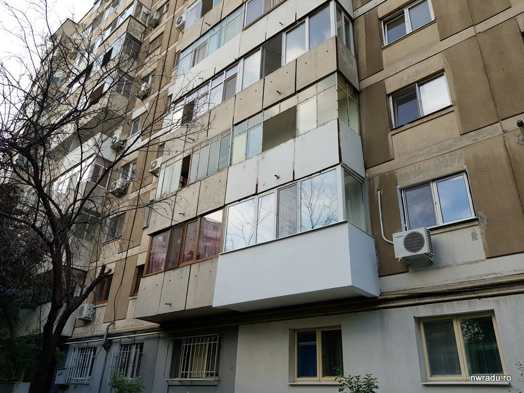

He lives in apartment (in a 4 level building)...this kind of concrete beauty:
(these are comunist buildings made in 1960-70-80) so they are pretty old and their respective electrical wiring is as old as the building is.
He said that has 4 electrical sockets in his apartment, that are making flames and smoke every time he is plugging in, any electrical device.
He called in an electrician, and that guy said is "because the wiring is OLD" and all the wiring in the concrete walls must be REPLACED.
The old original wiring is made from aluminium and is thick aproximatively 1cm diameter (he didnt check). They are heavy duty wires in a word. The electrician said they MUST be replaced with copper wires.

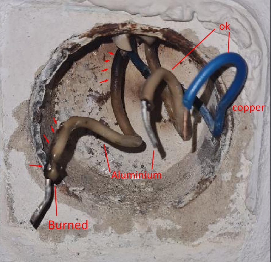

His mother plug in a washing machine into the same electrical socket for about 8 years. I opened the socket and take it out, to discover it was made from one big ceramic element inside, for isolation purposes, but it was shattered pieces now inside. Probably from forced plug ins along the time. The contacts seem OK, where you screw the wall wires,I didnt see that much play in there, but I didnt give it a thorough inspection, I took the wires out a bit too quickly. Again, it was shattered as well. But nothing was touching wrongly. Everything seem fine.
Only one aluminium wire (left one) was having its isolation heavily burned, and melted a little bit. The mother cut off the power of the washing machine in time. (she is using the same electrical socket for ~8 years).
The melted plastic isolation was melted in the oposite side plastic, they joined toghether, but on the same wire. I drag it out from its plastic melted shape and reveal the full wire. You can see the bottom and the upper side of the wire are burned but its middle isn't !!! - because it was like an O there.
I measured the wires before and after the change, and they all showing 230VAC. They are ok.
I installed a new power socket and screwed good the wires in there.
- My educated guess says that the wire was playing in the screw socket, and got hot from loose contact (over 8 years), until it got hot enough to melt the plastic, and because everything is pushed together, the 2 sides of the same wire got close enough and melted together.
After I installed the new electrical socket, I tested the washing machine for 30min running as usual.
After this time I put my palm on the wall and on the plastic case to feel if is hot or warm. It was cold, sign that everything is as 'new'.
Oh, and I was impressed that the power socket didn't melted at all inside, but that was because the ceramic body shielded and directed the heat towards the wire. And also the plug-in wire was not melted either,or its cord, only the wire inside the socket.

Anyway, mister @Megawatt was wright with his "tighten up all the wires" ;)
