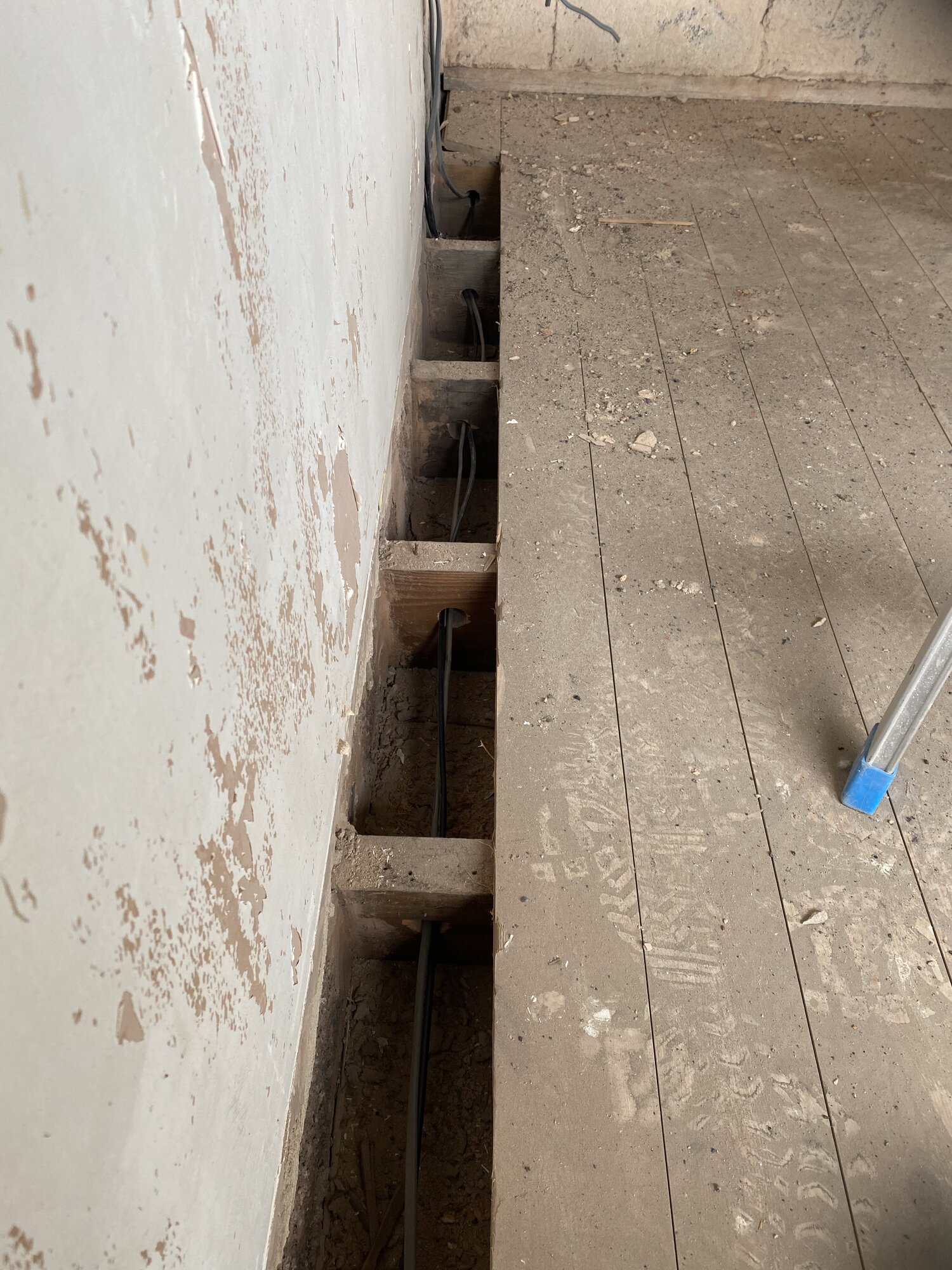

Employed electrician to wire extra sockets in bedrooms upstairs in an empty house. However I have noticed when I lifted floor board up to do other work, that the cables are running through holes close to ends of the joists, not within the safe zones, .25 & .4, as with Building Regs.
Looking for advise on how to approach this, with them.

We are promised pics. next weekend, but so far we have been told that they are 25mm holes in 5 x 2, and near the end.
It's difficult to see how this could have any significant affect on the structural integrity of the joists, but I'll wait for the pics.

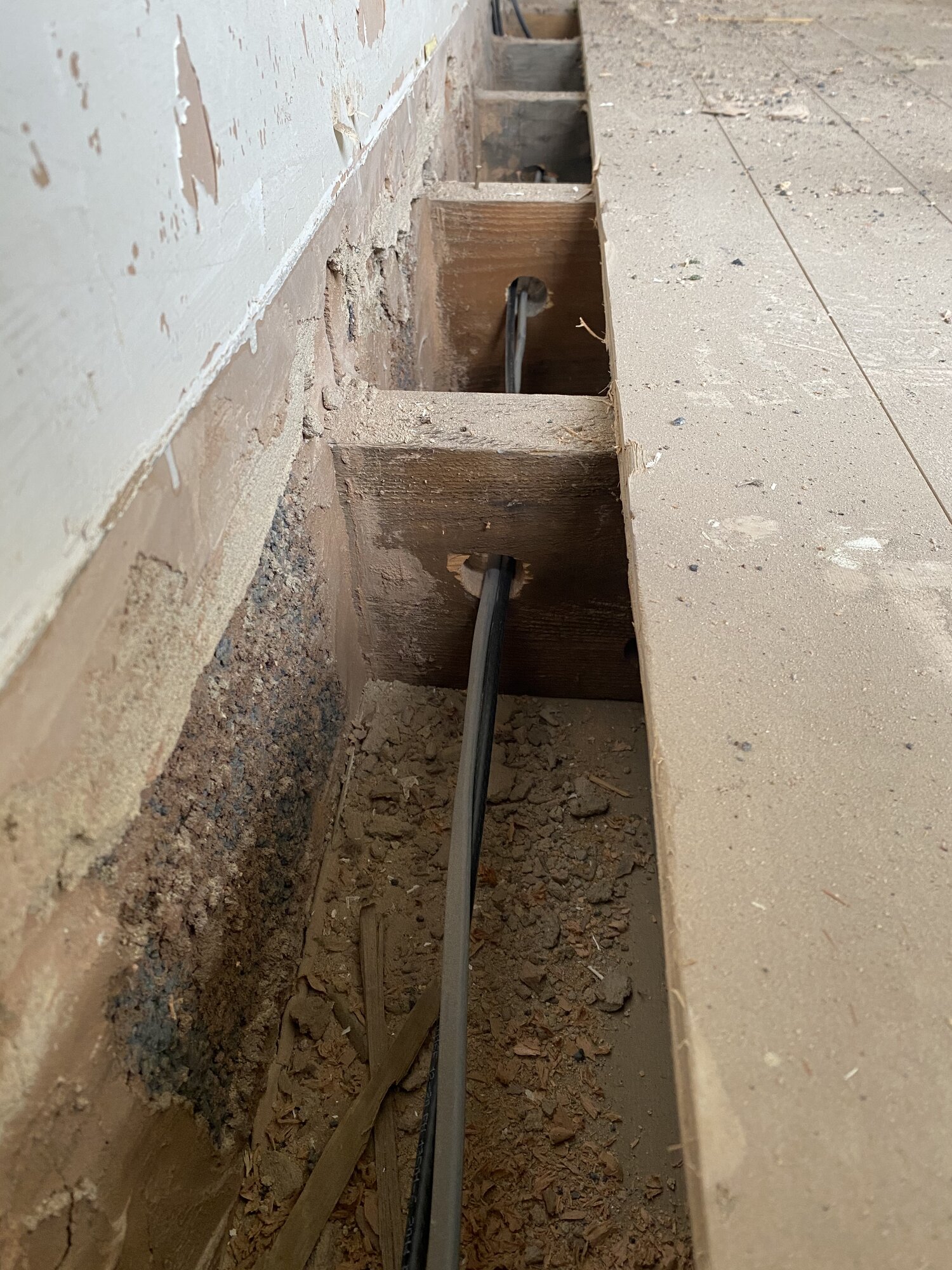

Here are the photos as promised, I’am ok with it as long as it not going to cause me problems in the future.

If that was new work in my house, like you, I wouldn't be happy.
There doesn't appear to be a reason for not putting the holes in the prescribed zones and, unless more cables are to be added, the holes appear to be larger than they need to be.
Was the same electrician responsible for the hole bottom left in the 2nd picture?
As I think Littlespark is alluding to, it's not good practice to run a signal cable such as coax so close to LV power cables.
All that being said, my house (Victorian era) has had many of the joists butchered over the years. Notches and holes out of prescribed zones and often very close together. Holes drilled at a 45 degree angle through the timber. The previous owner took a huge chunk out of a joist under the bathroom as they positioned the shower tray such that the waste outlet was on a joist. So far, the floors are still standing...!

The problem with deviating from guidance is you then have to qualify your choices.
We all know that there is an --- Cover Factor in many regs but if we venture there the onus is on us to demonstrate we have not introduced a hazard.
In solid, dry and rot free joists, like those, I can guarantee those holes will no be an issue but I cannot qualify that statement.
All I can offer is if it were my house I wouldn't be worrying.
As the electrician has deviated from the prescribed zones ask for his Hazard Analysis and Risk Assessment, that he obviously did, to satisfy himself that it was OK to do so.
Come off it Mike. Everyone here, including yourself, knows those joists aren't going to collapse.
To the OP: Of all the sins an electrician can commit, this is about as minor as it gets. Put the floorboards back down, and don't worry about it.
