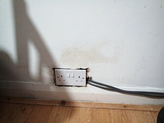

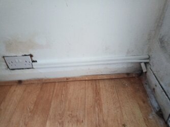

I have attached the two images. The before one shows what it looked like when the EICR was done. The after is what it looks like now that the council got involved and the landlord was forced to fix it in June 2022.

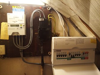

The Engineer came a few days ago and looked inside the fuse box and declared somebody had tampered with it. Nobody had. Here is a photo from the outside. The labels are also wrong. One says "garage" but the shed has no power connected to it....

I am hard put to see your issue. The wiring may not be the best but it is deemed safe. What are you complaining about exactly? So under ESPRS, the landlord must provide a copy of the EICR to the tenant. If you have not received that then take it up with your local council who are responsible for ensuring ESPRS is met by private landlords. Perhaps ask for Building Control and tell them you have not had a copy of the EICR. You might also explain any misgivings you have at the same time. By the way those cables are not exposed they are just poorly fixed. It seems this has been addressed though with the trunking, yes?

The wired were exposed in November when the EICRwas done. They were only fixed in June. I think the EICR is entirely manufactured between the electrician and the landlord.
As already said, there is nothing wrong with having the cables exposed as such.
A bit of a carp job though, they should have either chased the wall and filled around the socket or used surface mount.

Depending on your council, they may or may not be helpful - some of them have rental standards which they require every landlord to meet, others don't. Based on the finish around the socket, it may be that there are others non electrical issues that are also not up to standard? (Is that mould to the right hand wall?)
The pictures themselves don't look quite as dangerous as you think, though certainly the cables not being correctly clipped to the wall should have been noted on the EICR. Being exposed is not in itself an issue, if they are suitably secured.

On a final note, based on the labels on the consumer unit, someone needs to buy that electrician a spirit level!
😂 I thought it was my eyes with the labelling on the consumer unit. 🧐
Poor things like that do get alarm bells ringing however I don’t think that means that the electrician is a fraud. The cables not secured don’t present immediate danger but need to be securely fixed I’m on the borderline of C2/C3 on this one due to the potential of cable being pulled easily and causing harm.
