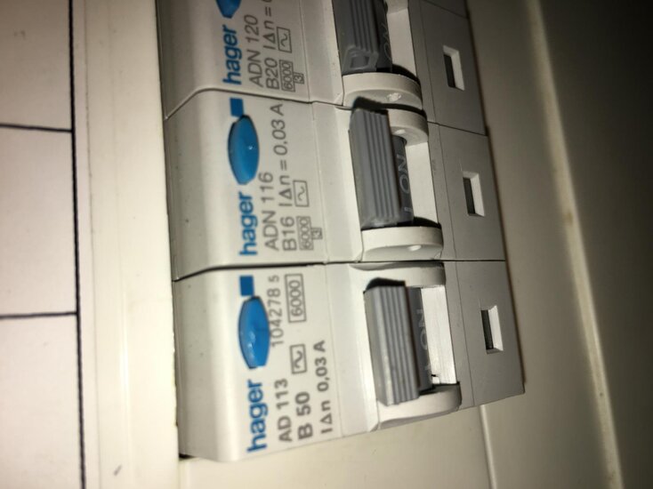

Yes that pic will fit inside a new CU. Just print it out small. ;)
Oh and the RCBOs will be compatible too as the ADN range is still current although cosmetically different. How come you need to know ?
guys got a plastic 15wayer (rcbos) which one of the circuits feeds a rcd unit- which feeds a smaller wylex board with plug in 3871's
and for some reason (genuinely of his own accord lol) wants it amalgamated into one c/u- obviously got too much dosh! -but he remembers it wasn't cheap for him to pay for all them rcbos last time lol! so wants them used in the new 20way 3rd amendment board I plan to put in
Ah fair enough. Strange one but should be a nice straightforward job. Loads of room for rcbos in the amd3 Hager units.
Same with any brands I have fitted, loads of room to fit RCBO's just not always loads of room to actually fit the consumer unit lol
