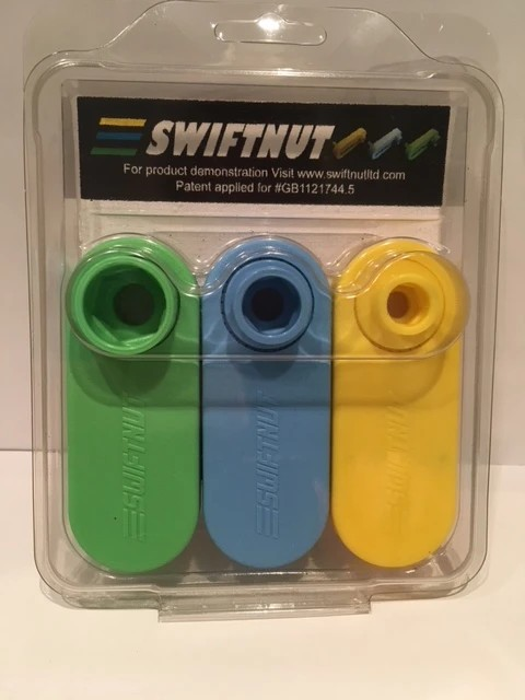

Swiftnut when your doing threaded bar after threaded bar after threaded bar......Spins it up the rod in no time, saves getting rsi while building trapezes!

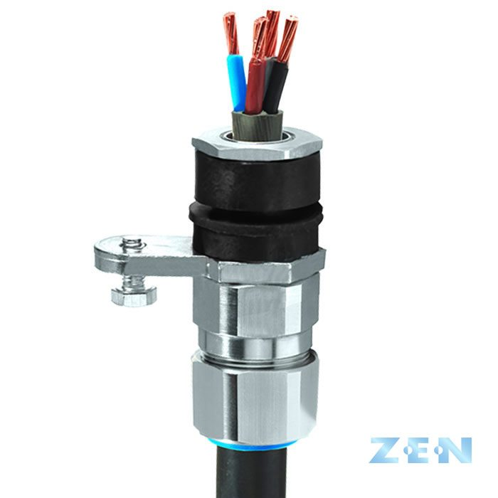

And CMP island glands for easy testing of sub main earth after sub main earth after sub main
earth......isolates gland from housing and easy to disconnect the lemon and lime!
