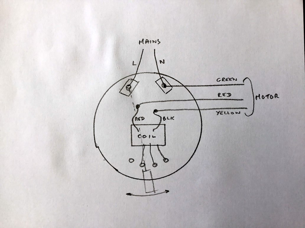

Below is my crude wiring diagram. I got the fan to work, prior to looking at this, but it does sizzle, smoke, and smell like something is burning from the fan head/motor (i unplugged immediately). According to your diagram, it looks like the G would go to the AC source, not R, but im not sure where R and Y go. Based on my diagram could you you help?

Your diagram shows an incorrect connection. The red wire from the motor should not connect to either of the screw terminals where the power cord is attached. It should connect only to the (probably red) wire from the transformer.
We now need to confirm that all the coils have continuity and are not short-circuited. Do you have a multimeter that you could use to take a few resistance measurements?
Lucien is of course right. You really do need a multimeter, both to check the motor windings still are the correct resistance (values in a posting on the AFCA site) and also to confirm the transformer connections. I think the wiring goes as my sketch below, but I'm making a rash assumption that the black wire (from the coil) is a tap on the winding of the transformer, rather than the end of it (you could establish that with the multimeter!).
NB Sorry for any confusion in the sketch - the faint line from the (L) terminal was supposed to indicate the lever of the switch - it's not a connection to the coil or red wire.
Do find a multimeter and carry out some checks rather than take pot luck and damage it!

There is one thing you could clarify for me - with your multimeter switched to a low ohms range - we want to measure tens of ohms probably - touch the probes together and check the meter reads about zero!
Then with everything disconnected, included my suggested connections, measure firstly between the red and black coil wires and note the result. Then measure between the black coil wire and the stud on the right (max speed setting) and note the resistance. In fact you might note the resistance to all the studs in sequence.

And Lucien's post at the same time as mine suggests a far more methodical start. So ignore my misguided suggestion to check if the coil is connected correctly!
My first move would be to check the resistance of the two motor windings and confirm the leads are correctly labelled. Because if there is something wrong with the motor then nothing else matters until that is repaired / rewound.
