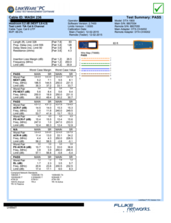

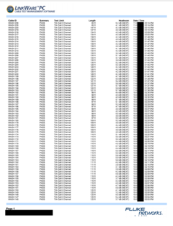

A certification tool (A Fluke DTX or DSP) is the only tool that will confirm its parameters are at spec, any professional, qualified installer would have this.
Capability of the cabling? The capability of the cabling should be within the spec??
Testing the cabling to ensure damage free correct termination can be confirmed by a proper tester. Although, they usually have flashing lights.
The capability of the cabling after it has been installed, poor installation practice can dramatically affect the performance of data cables.
Tight bends, kinks, overtightened cable ties, crushing, poor termination can all reduce the performance of the cable but still pass a basic continuity test.
A 'proper tester' doesn't confirm continuity or just have flashy lights. You are thinking of the basic continuity checkers available for ~£5, a 'proper' tester is more likely to set you back £5000.
