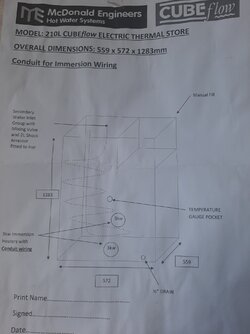

Thanks so much for your response! as a layperson I'm not sure how I would check this from the outside, but I have attached a diagram of the picture that was left by the installers, if this helps? to me it looks like there might just be one?

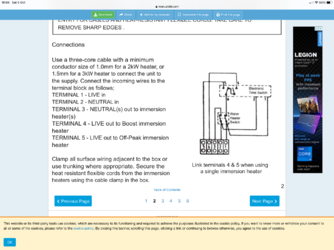

Sorry I described how ours was wired!!
I see it is possible to wire them for one immersion heater, so it might be the necessary link is not in place.
Need a competent person to look inside to check the wiring.
Thanks for the diagram of the heat store.
it does show two immersions can be fitted.
If you look at your thermal store, can you identify where the two immersions would be fitted, and whether there are actually two there, or just the lower one. Or is the thermal store cladded so you can't see any of the 'insides'?
I would expect a white flex to be coming out of each immersion, each going to the Horstmann timer.
Is your timer in the vicinity of the tank, so you can trace the wire or wires, or is it further away so that would be more difficult?

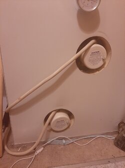

Thanks for confirming! all the wires to the timer go through the back of the wall for this one, but there's 2 wires coming out of the front which I can now see are for the 2 heaters. pic attached. sounds to me that if both heaters are wired yp, the boost should theoretically be working, and I should get someone to come and check the wiring?
OK. So your boost button ought to be turning on the upper immersion.
Really you need someone competent with a tester to ensure mains is getting to the immersion, and to check the immersion element and the thermostat.
It's more usual for the bottom heater element to fail as it's on for a lot longer than the boost one.
You might have a connection problem, or at worst the immersion heater itself might have to be replaced.
Or a less elegant solution, if the upper immersion is duff, could be for an electrician to add the link to the timer so that the lower immersion does the boost function as well. A downside could be this provides a less cost effective boost.
