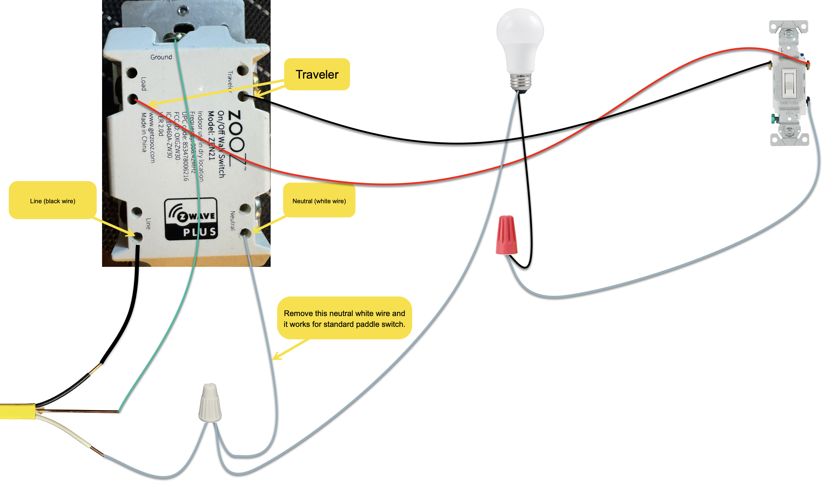

The following dead-end 3-way wiring diagram shows my current setup with the Zooz Zen21, but it's not working. This wiring works fine with a simple standard paddle 3-way switch that doesn't require a neutral wire. However, since the Zooz switch requires a neutral wire, I ran a white wire from the capped neutral wire from the breaker and the light switch to the neutral slot in the Zooz, but it didn't work. Is there another way to get the Zooz switch to work? Thank you in advance.

Try switching your travelers, other than that it looks like it should work

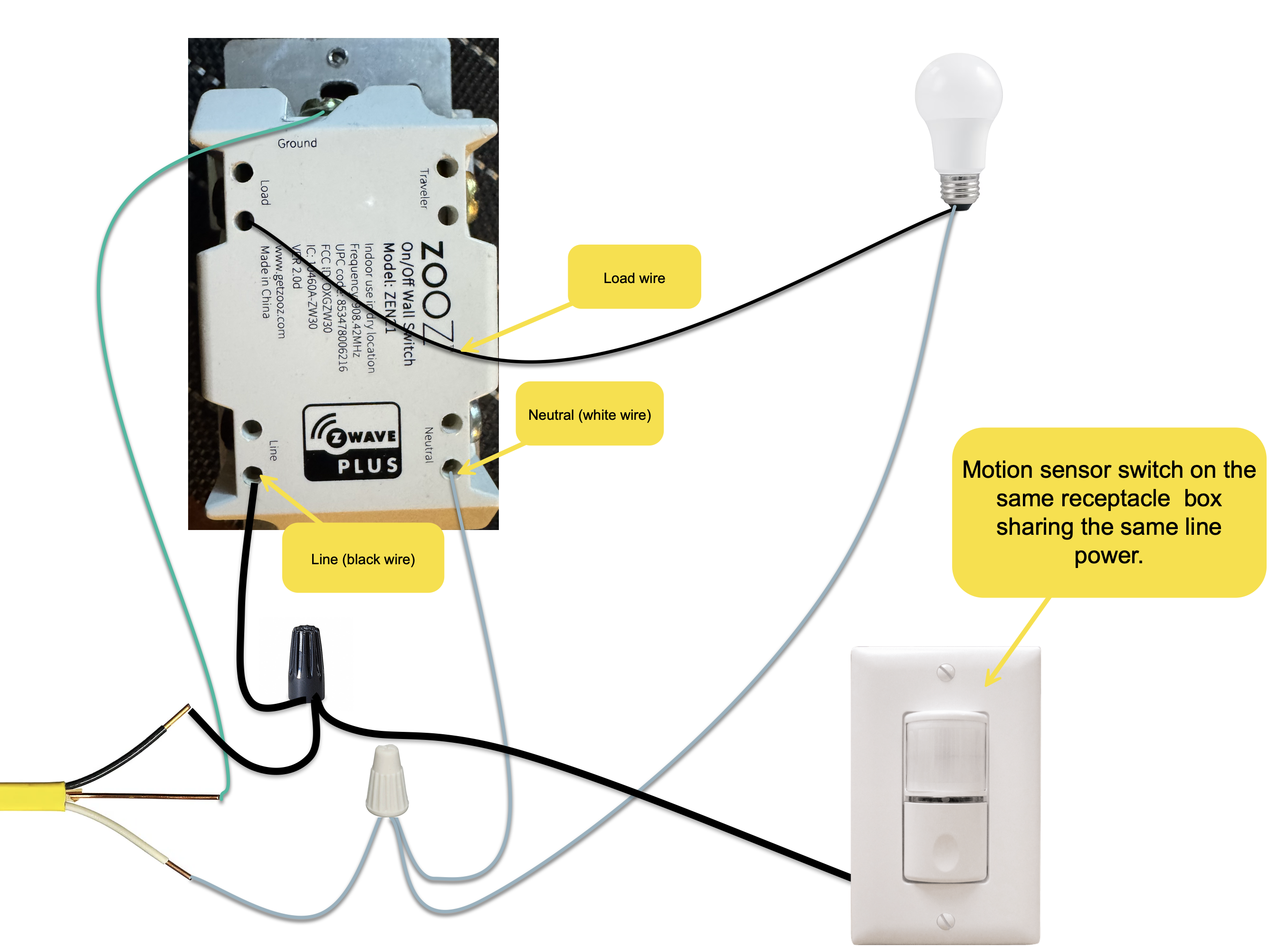

To simplify everything, I ignore the second switch in the garage and just use the Zooz switch to try to turn on the light switch. I have the following wiring and it's not working. I have tried the Zooz Zen72, Zen21, and the Kasa HS200 single pole switch. All of these smart switches that requires the neutral is unable to turn the light on with the following wiring diagram.
However, if I did the same thing with the standard paddle switch but this time capped the neutral wires together since the standard paddle switch does not require a neutral wire. It works perfectly fine with this wiring.
So, what's wrong with my wiring on the smart switches? Why are all of them not able to turn the light on?

On the Zooz Zen72 switch:
When the switch is off: Neutral to Load = 0.066v
When the switch is on: Neutral to Load = 3.340v
When the switch is on, the load wire does have power and vice versa.

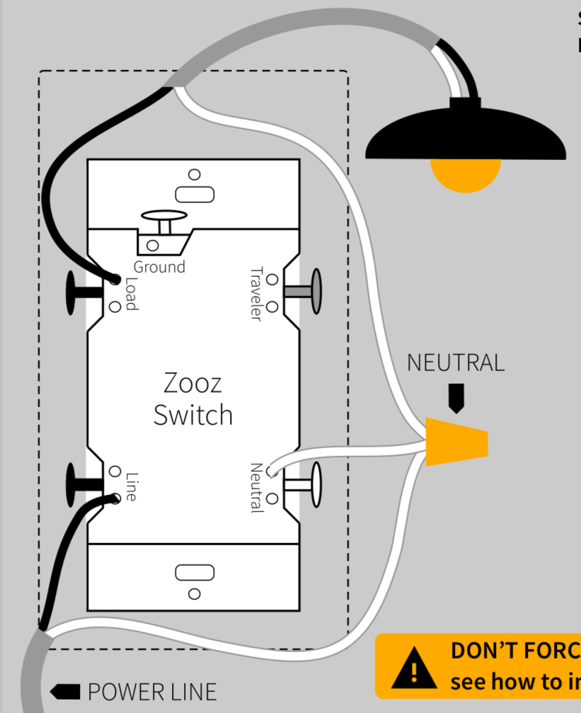

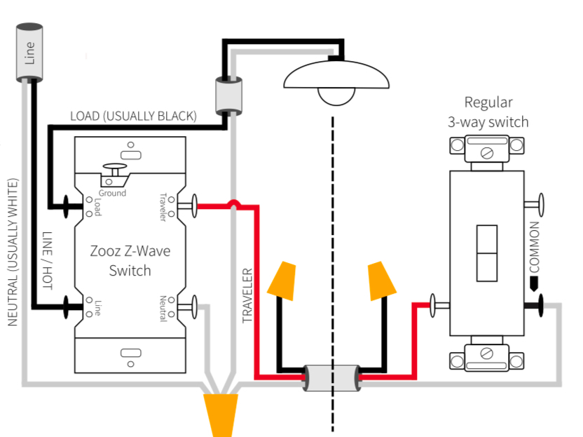

And just to say the wiring you show in post #1 is not consistent with the ZEN21 instructions.
But this may not be the only problem.
The regular switch only used two wires in all the Zooz documentation I can see.

Zooz switch off:
Line to Load = 121.2v
Line to Neutral 121v
Load to Neutral = 0.066v
Load to Ground = 0.0073v
Neutral to Ground = 0.009v
Zooz switch on:
Line to Load = 116.3v
Line to Neutral = 121v
Load to Neutral = 3.382v
Load to Ground = 3.349v
Neutral to Ground = 0.012v
I know for sure that the other switch and the light is not the source of the power. I've measured the voltage of those wires already.

Here are the instructions.
