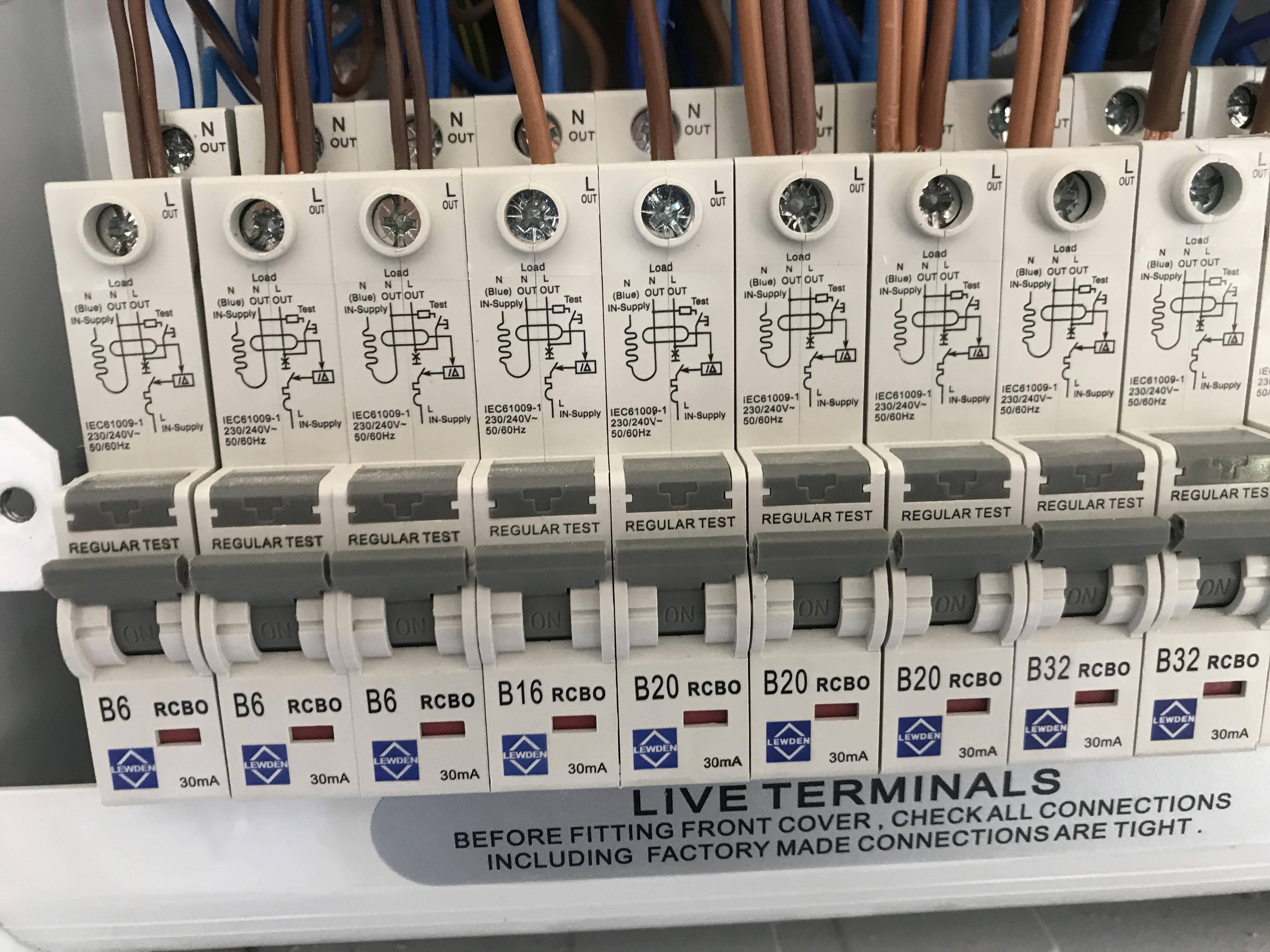

Well this is a new one on me, new build, very expensive large house, 1 x rfc and radial crammed into in one 20amp rcbo x 2 and multiple circuits in the three 6 amp rcbo's?
Looks like a poor design with no spare ways so have ended up doubling and tripling up at the board
I must admit have done this when adding to an already jammed packed existing board
But on a brand new install it’s just lazy not to go out and buy a bigger board and some more rcbos
Remember a spur can be taken at the origin of the circuit. This would still be one circuit.
As Dusty says though, it seems poor on a new build to have no spare ways from the start.
