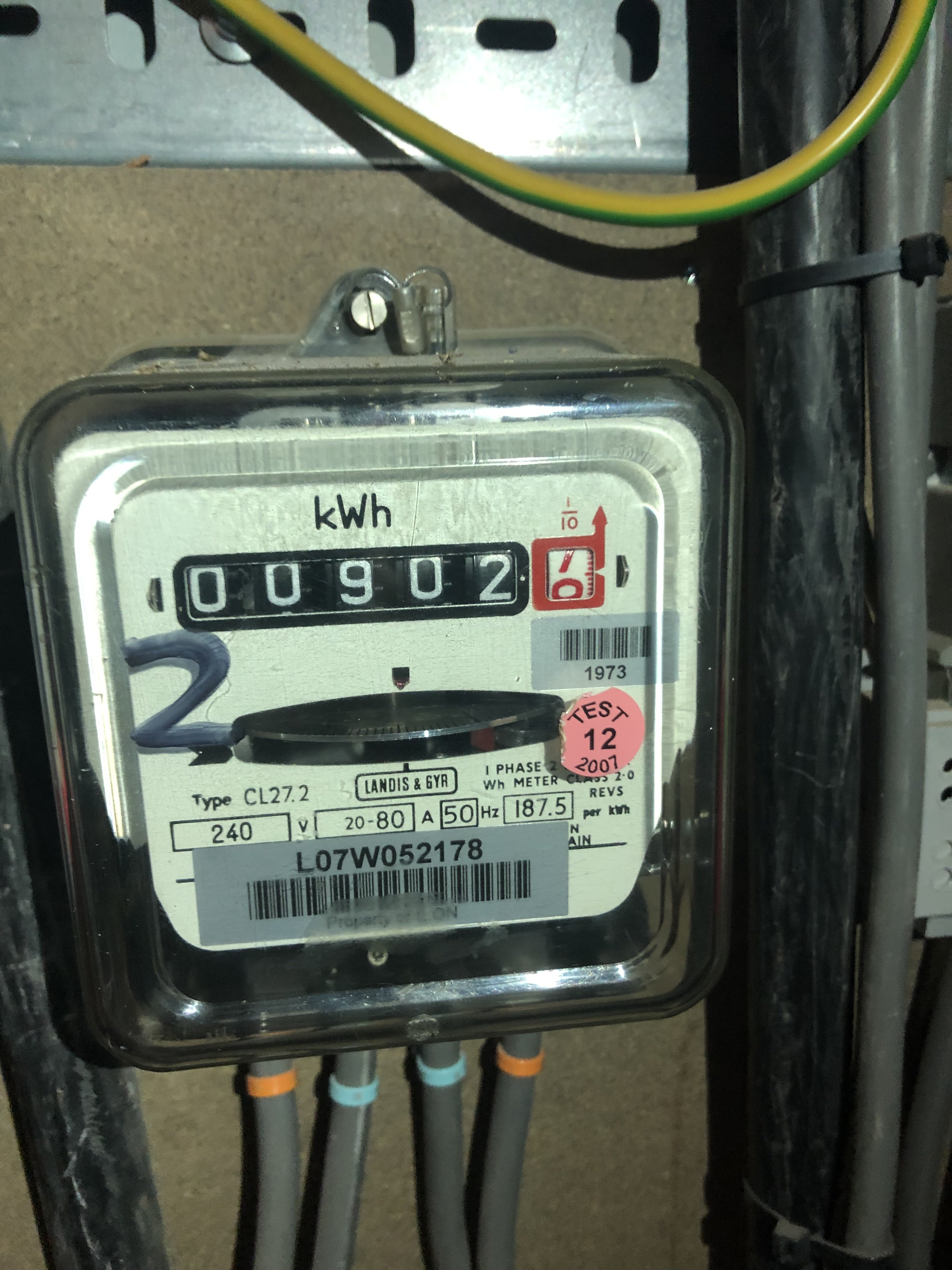

Hi guys, I have a question about economy 7. I have a water heater The Horstmann Economy 7 Quartz. However, my meter reading is single rate. How should I use the water? Is still economy 7 available for me when I don’t have two rate meter reading?
The second question about water heater. There is not enough hot water in it. In the morning, the water is hot, however, at the evening is warm for a while and then cold but it is the most needed then. The situation happens no matter how much water was used during the day. Is it a problem with insulation?
Please, help me and thanks for all advices!

The way the timer works is that the element heats up between say 12 and 5am (which if you had a dual rate meter you would be charge less for your electric) and then you have a boost feature to either heat up the same element or if you have 2 elements the higher one, this boost feature is if you turn the dial it heats the water for an hour or so

I understand that. The thing is that I do not have a dual rate meter, just single one

I know how to use the water heater. My question is how I should use the electricity to make it efficient. Should I use it during the night or it doesn't matter as I don't have a dual rate meter?

as you have a single rate meter you get charged the same rate regardless of the time you use it
You could look into a dual rate meter,but if it is for just heating hot water then it is not cheaper.
Economy 7 was a tariff for those that had night storage electric heating ie "cheaper to heat in off peak periods"
The timer you have was designed for those instances but are now called EQ7 so people are not so confused as they can be used regardless of tariffs
There are many tariffs offered by your supply company so do some research and see what is best for you

Electrical heating is 100% efficient however you use it as all the electrical energy gets transferred to heat. But it is expensive, approx 3 times the cost of gas. If you have a dual rate meter it will be cheaper at night, but your standing charge will be higher.
... but your daytime rate is more expensive too... so unless you dedicate your life to using the vast majority of your electricity at night... forget dual rate. (correct at time of posting)
Agree with @UKMeterman , we need to see a wider shot of the electrical set up of your meters.
It looks to me as a communal meter cupboard in a block of flats?
I see a couple of chunky armoured cables and cable tray... not usual in domestic
The number 2 hand written on the meter also makes us think there is a number 1 meter somewhere in the set up.
How is your rooms heated? have you got storage heaters, or any electric heating?
Gas central heating, in which case isn't the water heated by that?
Like others I think that is not likely to be the only meter for the property. Even if the meter was started at 0, which they usually aren't, that's a very low usage for the age of the meter.
The number 2 could just indicate that it is flat number 2 or similar.
Also white faced meters, or completely white meters were traditionally used for the off peak supply.
