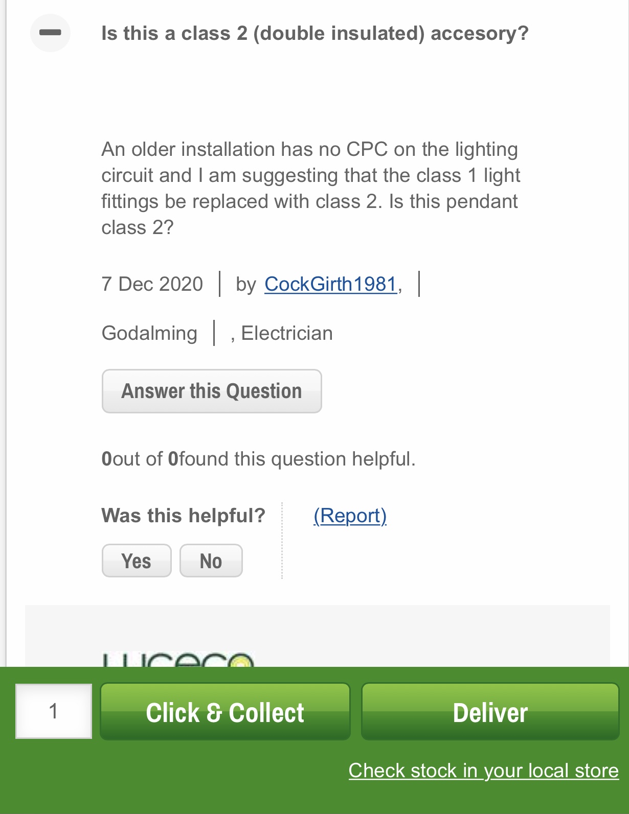

Am I correct in thinking this?

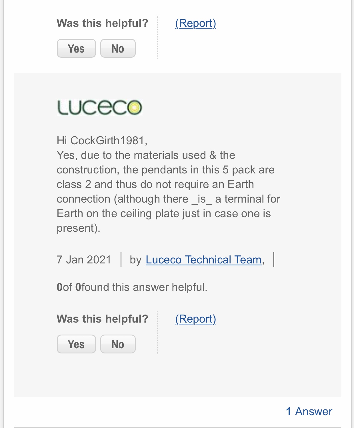

The reason I ask is Screwfix have replied to someone’s question that it is a class 1 and requires an earth? Even though it is only used to loop in/out.
Can anyone clarify this for me.
Thanks E4F9170E-4F95-44C1-B671-7ACCE8B5BBFF.jpegA7B978CF-7918-4E13-8D37-39AFE2E772C6.jpeg
I would say the pendant as a whole is NOT class 2. It has an earth terminal and so cannot be defined as class 2.
I'd say that the earth terminal within an insulated pendant base is purely there as either a parking or loop terminal depending on the wiring method and serves no other purpose with regard to the fitting. So in a situation where the lighting cable has no cpc and rewiring just isn't an option at that time then the pendant is a far safer and satisfactory alternative to a metal Class 1 fitting.
Agree. But it's not classified as class II.
For flip's sake, that's my post blown out of the water. Cheers!
But then, hold on - that's only the holder part. The assembly is not class 2.

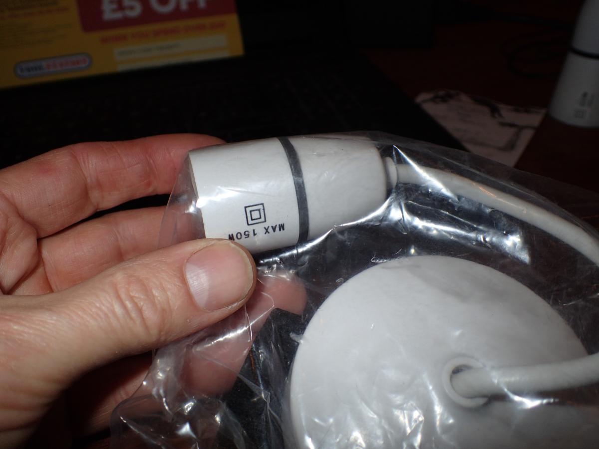

just checked a BG pendant and it has no symbols or markings to help us.
and for the first time ever, i have actually read the enclosed instruction leaflet and it also has no useful information.
I'm sure any assembly that has an earth point or an earth cable entering it cannot be classified as a class 2 device. I would put a fiver on it. And I'm from Yorkshire.
And if that has no symbols on it then that confirms it isn't class 2.

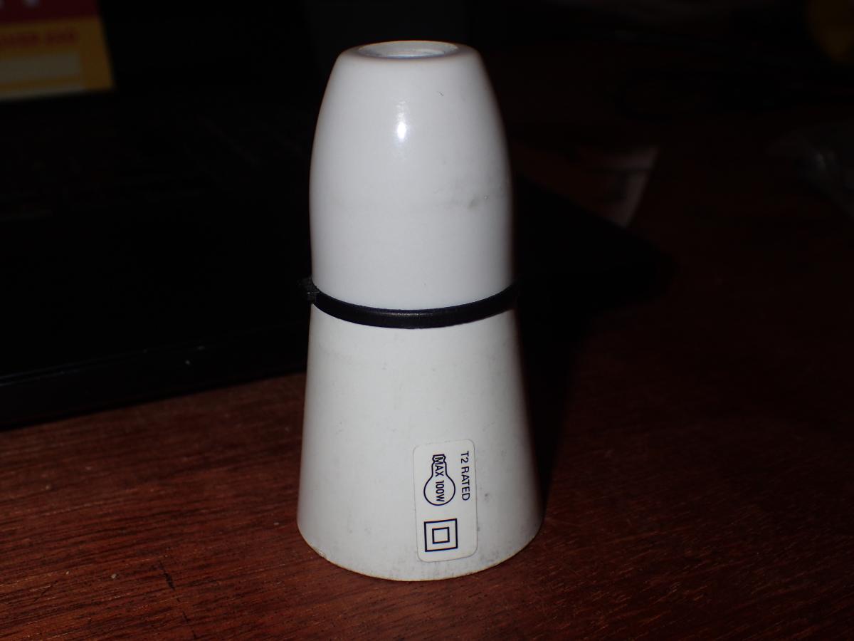

There is no way that pendant holder it Class II is has exposed live pins. The part no is K1170RPWHI and the only site which shows that symbol is Amazon none of the other sites do.
So Amazon is adding unauthorised 'Double insulated' labels to a product?
Sounds a bit like my dubious market trader relative and his roll of self adhesive 'CE' labels.
Who knows but it is odd this product on other sites does not show it and its position and everything about it is odd.
