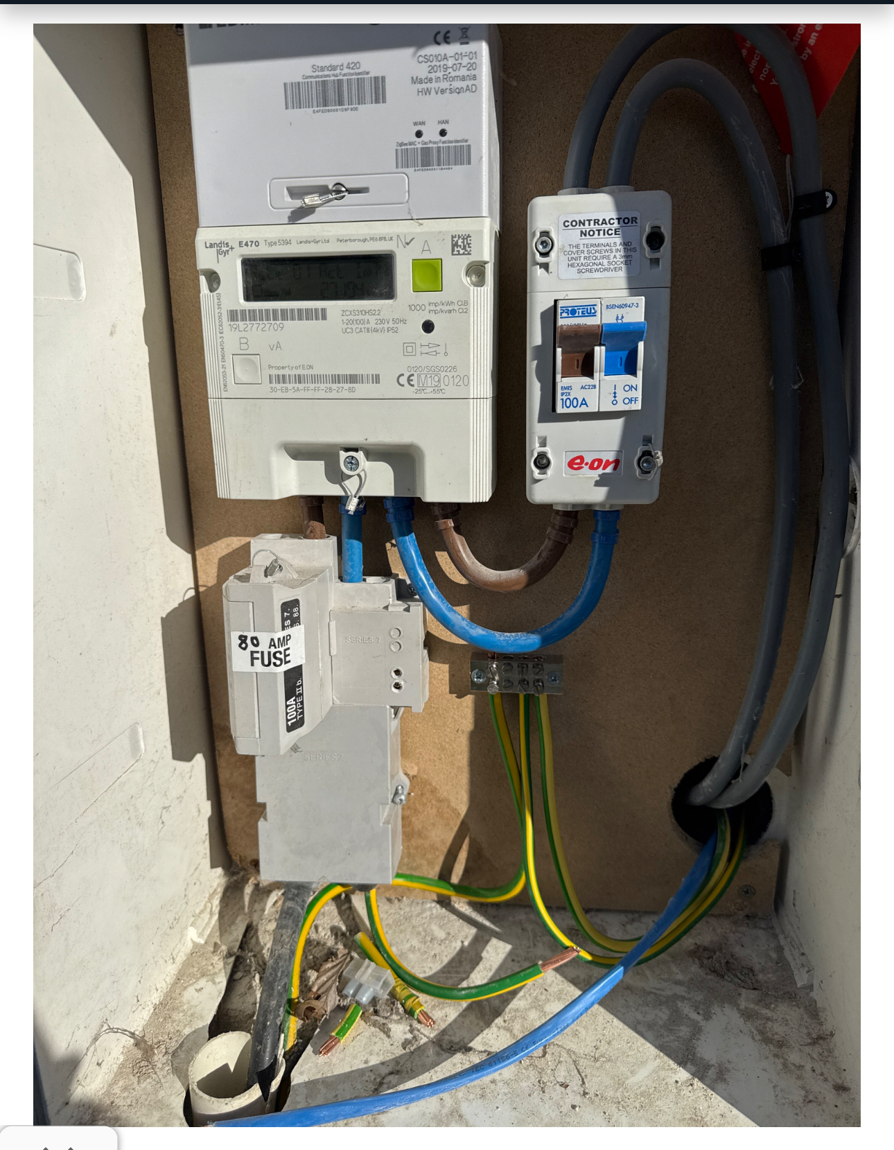

Hi - i'm very much a layman here but hoping someone can shine a bit of light on this for me as i feel like i'm getting messed about a bit - but not sure by whom.

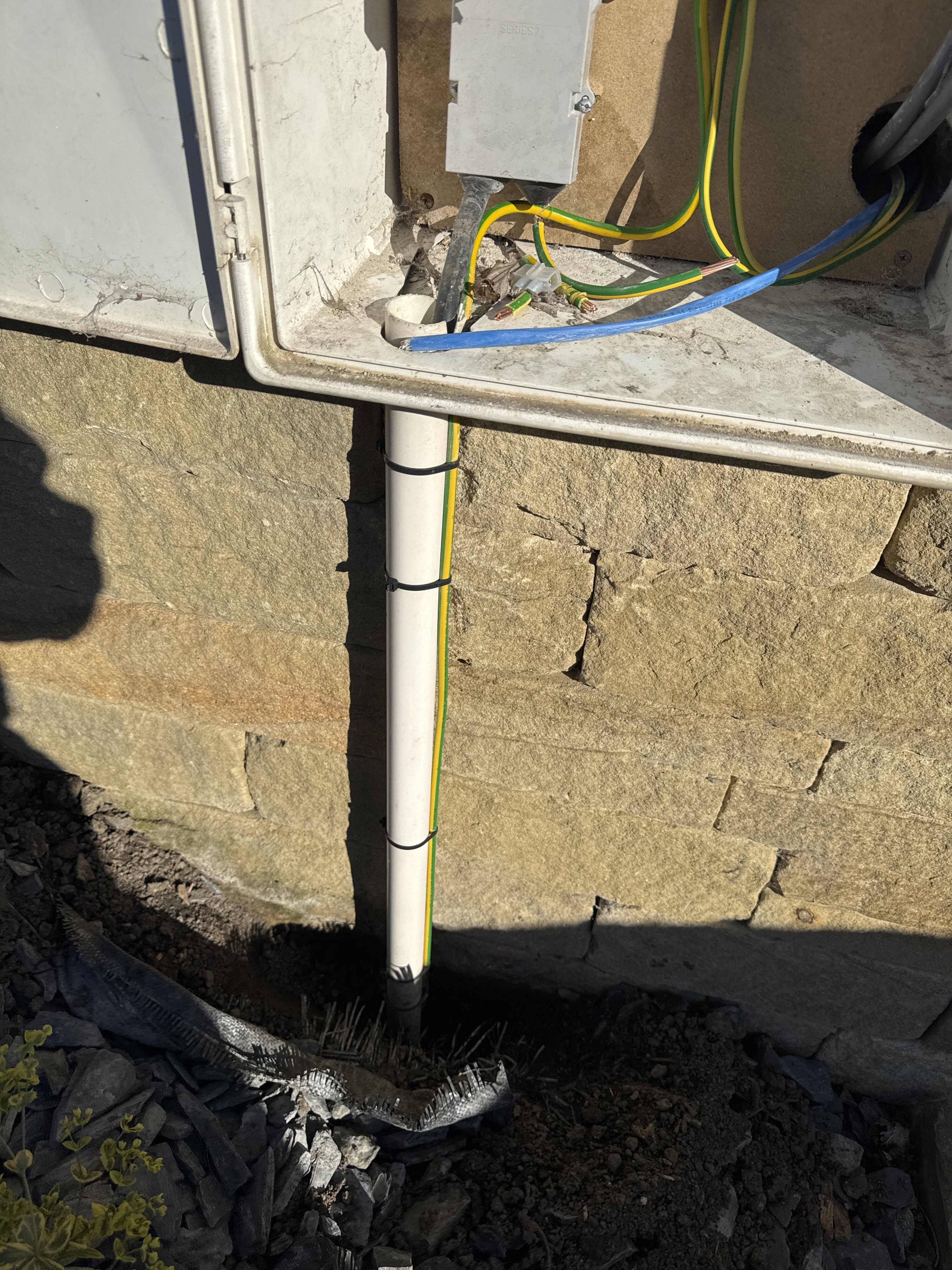

House was built in 2020 by a local building firm. We have the DEIC which states it has TNS earthing, and the means of earthing as 'Distributors Facility'. There is nothing in the 'where an earth electrode is used' section. Octopus have been out to install an EV charger today but are adamant it's not a TNS, but instead is a TT earthing arrangement. The electricians who were involved in the building of the property weren't that helpful when i called one of the owners (who signed the DEIC) as he said he can't remember how it was set up. There is a green/yellow wire attached to the pipe that runs down the wall from the meter, but it's in a raised garden bed and goes pretty deep underground - we can't find an earth rod anywhere obvious.
We've called the DNO connections team as advised by the installer and they've emailed back to say they will be in touch shortly to arrange to 'provide a connection to earth'. I've emailed back asking for their records regarding the connection and the manner of earthing.
The installer said the measurements indicate that the property is earthed, but because they don't know how, they won't connect the charger. He referred to the supply parameters which show Z as 0.11, and he says he measured 0.15, but when he tested the charger it showed 0.53 so he doesn't understand how the electrician got the measurements he got. None of this means much to me!
I suspect the installer is wrong and that it is a TNS system as everything else seems to look that way - other than waiting for the DNO to get back to me and hopefully confirm the setup so i can go back to Octopus to complain, is there anything I can do to speed this up? I've asked the electricians to come back out to look at the unit but not sure if when they will come - and i'd rather not incur more expense.
Appreciate any help I can get. Thank you!

You have an Electrical Installation Certificate that states TNS and the test results are consistent with it being TNS
TNS would be a max Ze of 0.8 TNCS would be a max Ze of 0.35, TT will generally be a lot higher than those values.
Octopus must have some reason to believe that it is TT and I assume it is what they have observed visually. Your DNO should be able to advise you of the Earthing arrangements you have.
May be a picture of your service head would help.

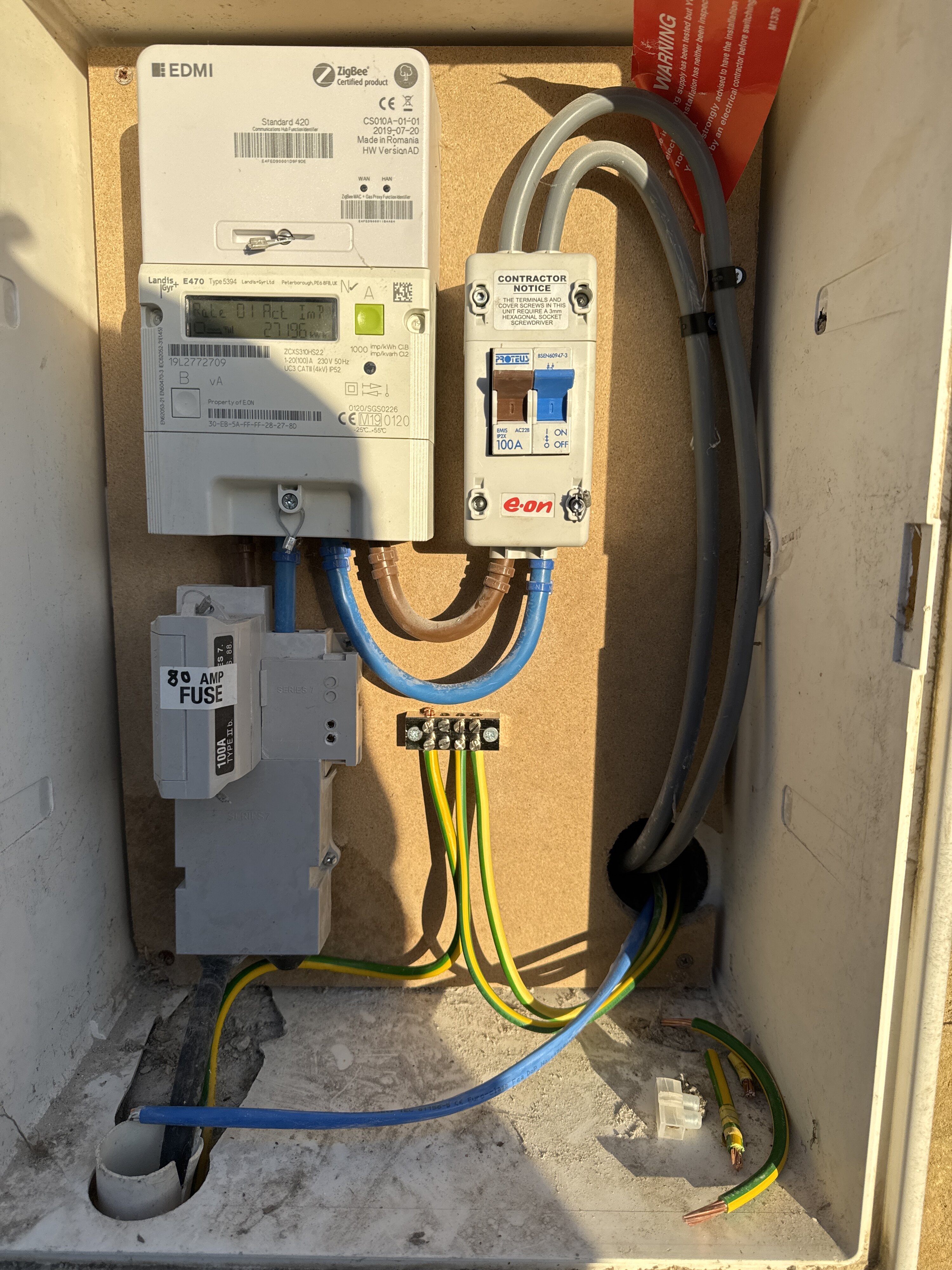

Thank you - I’ve uploaded some photos
I’ve uploaded 3 pics but 2 are awaiting mod approval. Hopefully they show up soon
Looks like we can rule out TNS!
Cannot rule out TNCS without seeing more of that service head, those other pictures haven't come through. The Earth cable could then be a Bonding conductor for Water or Gas that was easier to route externally.
Certainly can see why Octopus think it is TT and since they have seen this I am going to guess there is no Earth connection at the top of that Service Head which would make it TNCS.
Can't believe they left those scraps there and the service head looks like it is not properly fixed on one side.
If it isn't TNCS then we must assume it is TT but the dilemma Octopus have is the readings don't align to TT and they cannot find the Earth Rod so I have to agree the earthing system is not proven.
There are other ways to provide TT other than Earth Rods though, like buried Earth mats or the use of Structural Steelwork these can result in lower readings than typically that which earth rods can provide.
This will be sorted out and I totally understand your frustration but can see why Octopus have not gone ahead with the install with what has been shown.
It is impossible to say for certain the earthing system without being there to investigate.

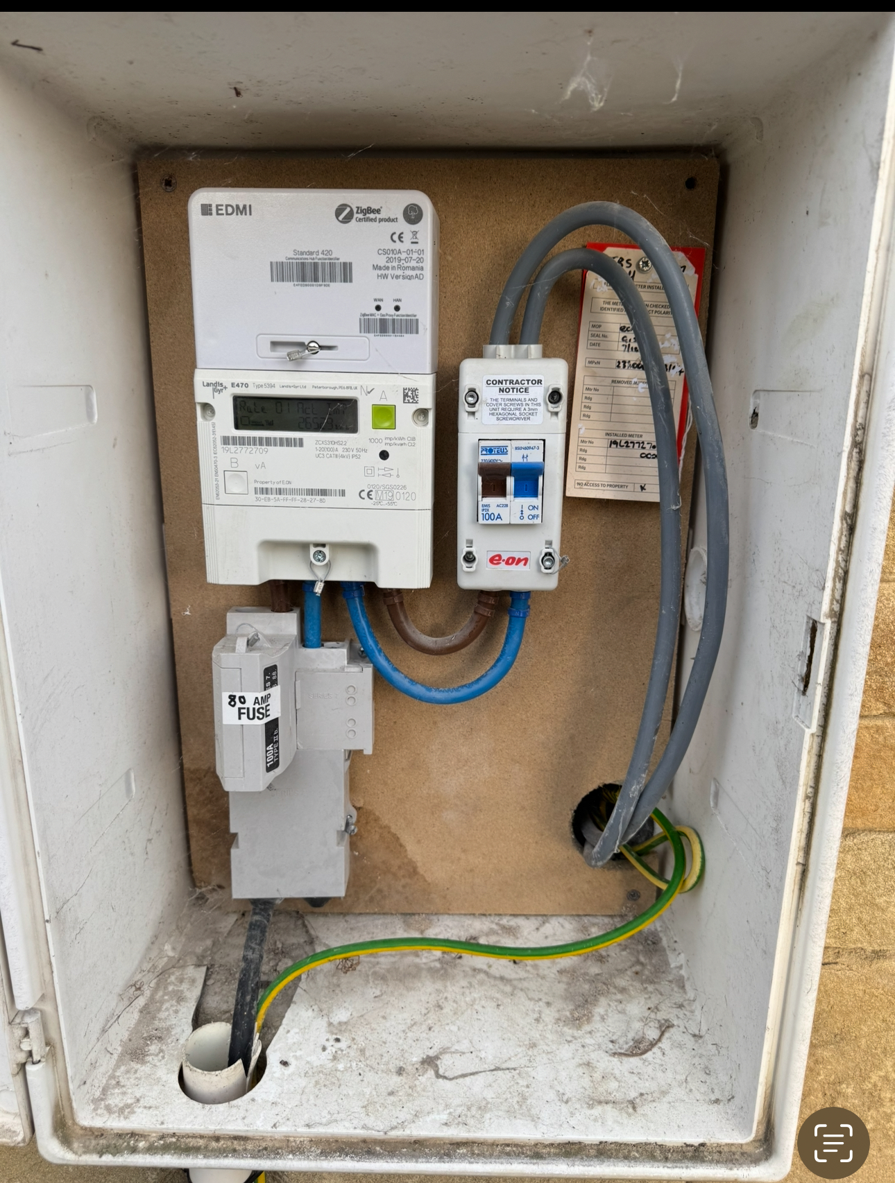

I'm wondering if that earth you moved was the earth from the head to the terminal block, looks the correct length and something has been used through the two screw holes.
Oh I see what you mean now - the two holes on the front of the head and then running to where the other green/yellow cables are? Would that potentially be the earth? What format would that take as the EIC says TNS?
TNCS
That bit of cable would have been the link as Westward said
It is stripped both ends and is about the right length as he pointed out.
DNO will confirm if it is TNCS then they will need to reconnect the Earthing.
Then that Earth cable running down the pipe is likely Gas or Water Bonding run externally.
