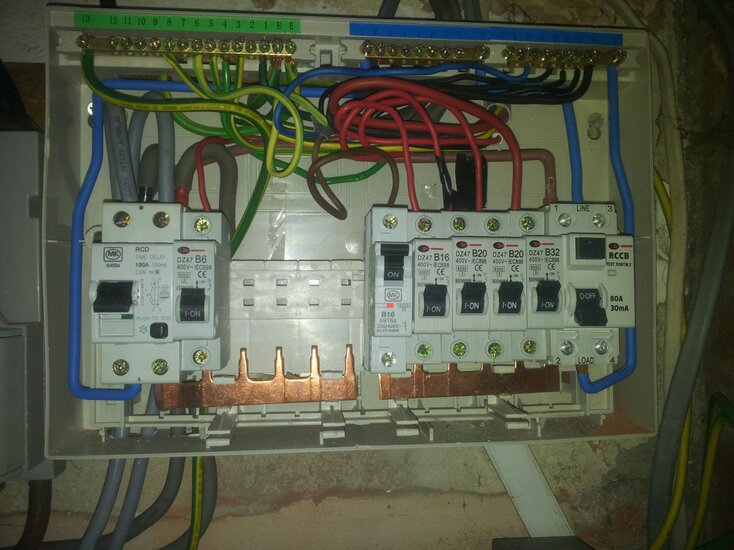

I am looking for an RCBO to fit this board.

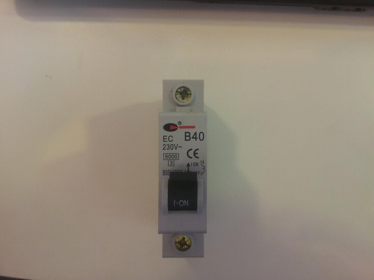

Do all the breakers with the lewden (or denmans) logo (triangle pointing right in a black oval) have the same fittings? For example some MCB's have 'EC' on them whereas this CU has 'DZ47', also the RCBO's with this same logo do not have any markings apart from the logo. I would have thought they all fit, but just wanted to be sure?

I can see that they have used MK in there for the S type RCD and one of the MCB's but I would like to stick to an original breaker.

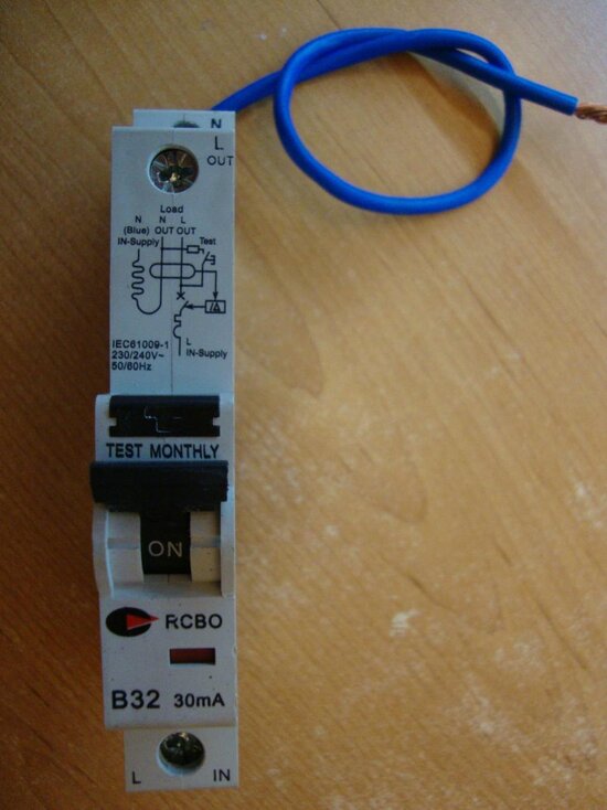

I have a couple of 20A RCBO's ( B Curve 30mA ), any good? You don't mention the size you are looking for.

I'm looking for a 6A B curve, however it's more whether the triangle with black oval sign means they are all interchangeable.

No problem, if you ever need 20's I've got 2. As for the interchangeability I'm not sure, the ones I have are from an upgrade where I put some 32's in for a ring . Happy hunting.

The circuit breakers in that board are Control Gear Direct, a terrible brand imho. The RCBO's should fit fine - until they fail which seems to be quite often...it's possibly why the board has a couple of MK items in it, the originals failed and have been replaced
