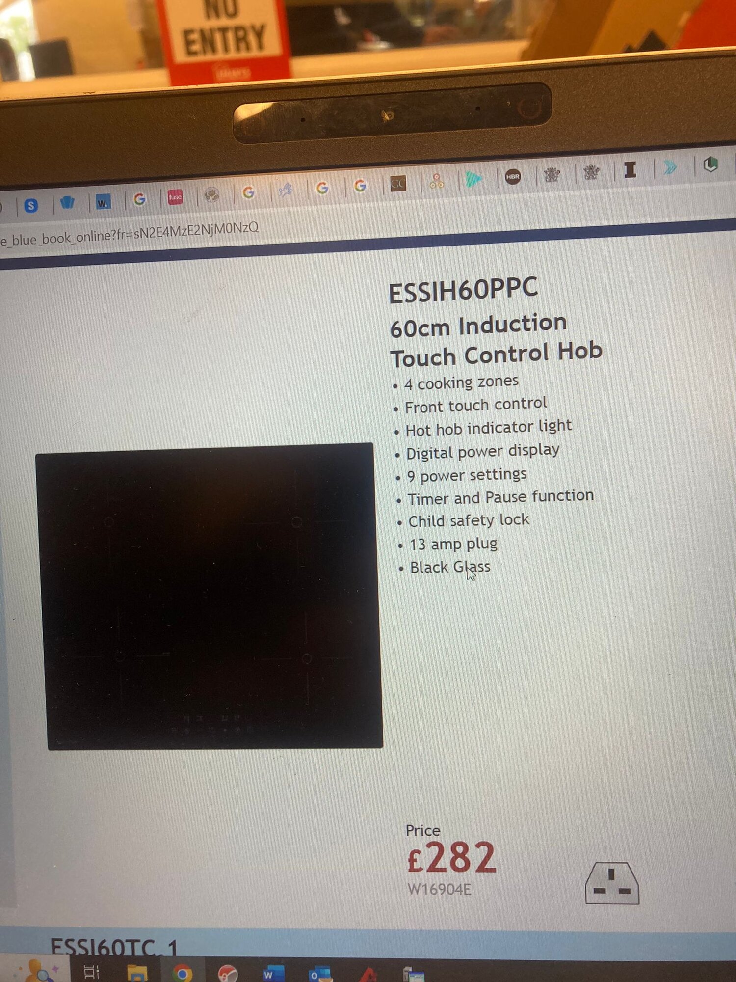

Right, things make even more sense today, the customer never brought the original hob that they sent me, they’ve got a completely different one and never told me.
I have attached photos of before and after.
Then, looking further into the operating instructions, each hob is 1200-2000watt so that explains the bigger cable/MCB now.

The first picture says it has a 13A plug.

The 13amp plug is what the customer originally sent me for approval then without telling me they have brought a different hob. Then I saw 2000watt on the box and assumed it was the original hob and required 8amps or there about.
