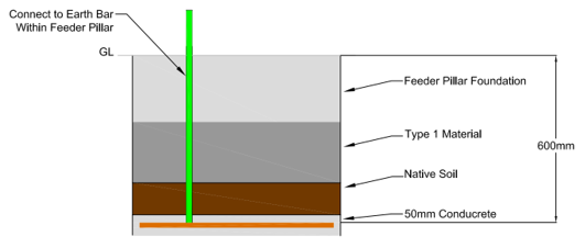

Consider condu-disc and condu-crete.
Thanks .....but I already have!
In this case I'm not sure it's the obvious choice as there is already a nice big long deep trench. The internet is silent about the actual cost of them, and anything you have to ask the price of is usually liable to require a stiff drink afterwards to recover.
It is quite surprising how you can never find the price for some these pieces of kit and that also casts doubt on the availability
I am always suspicious of products that are not quoted (unless obvious issue like custom build) as experience has taught me it means "stupidly expensive, but now we will pester you with sales calls".
The Conducrete looks useful, but it appears to be extremely difficult to get hold of. Why is this product not readily available at electrical wholesalers?
