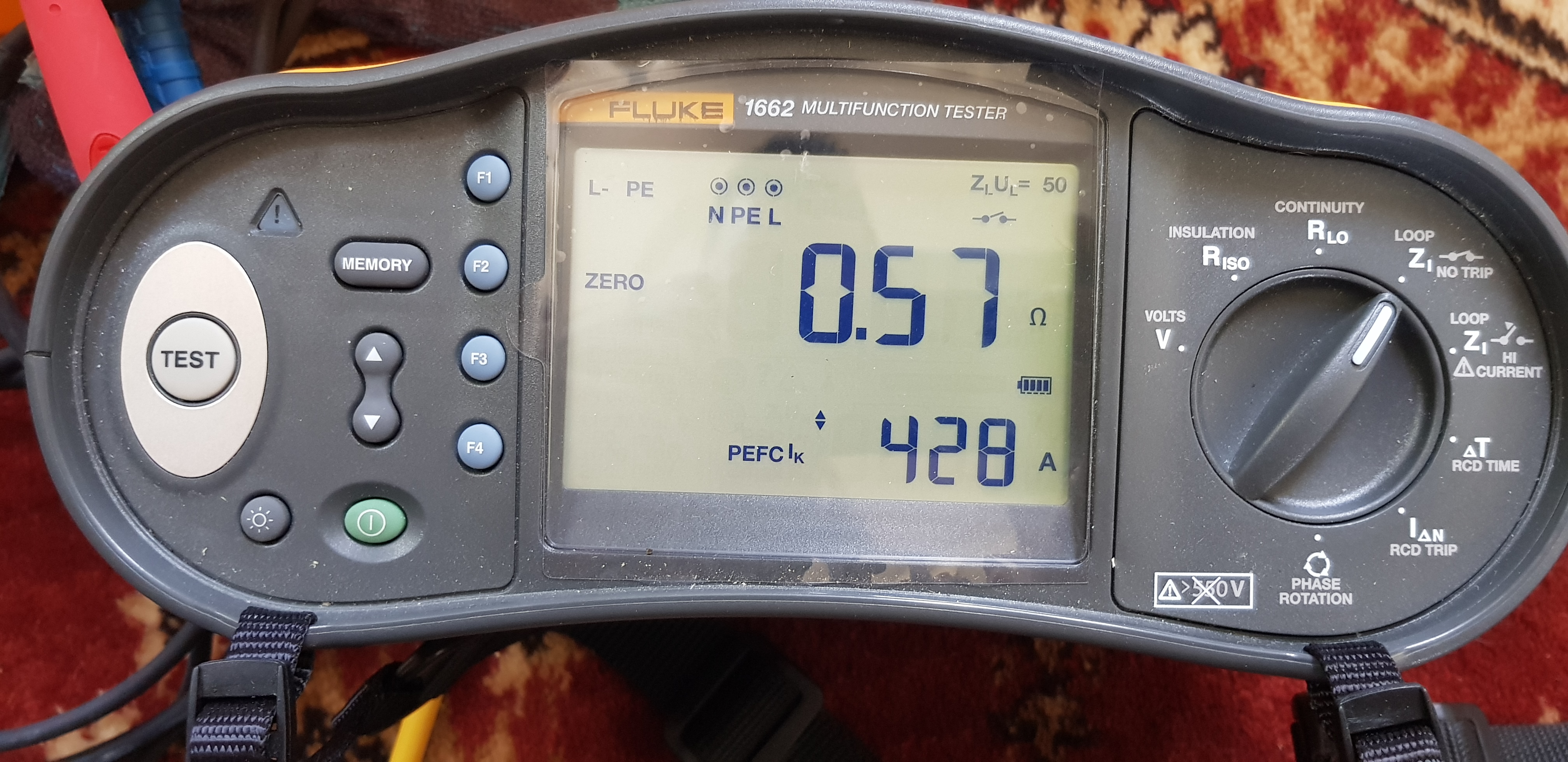

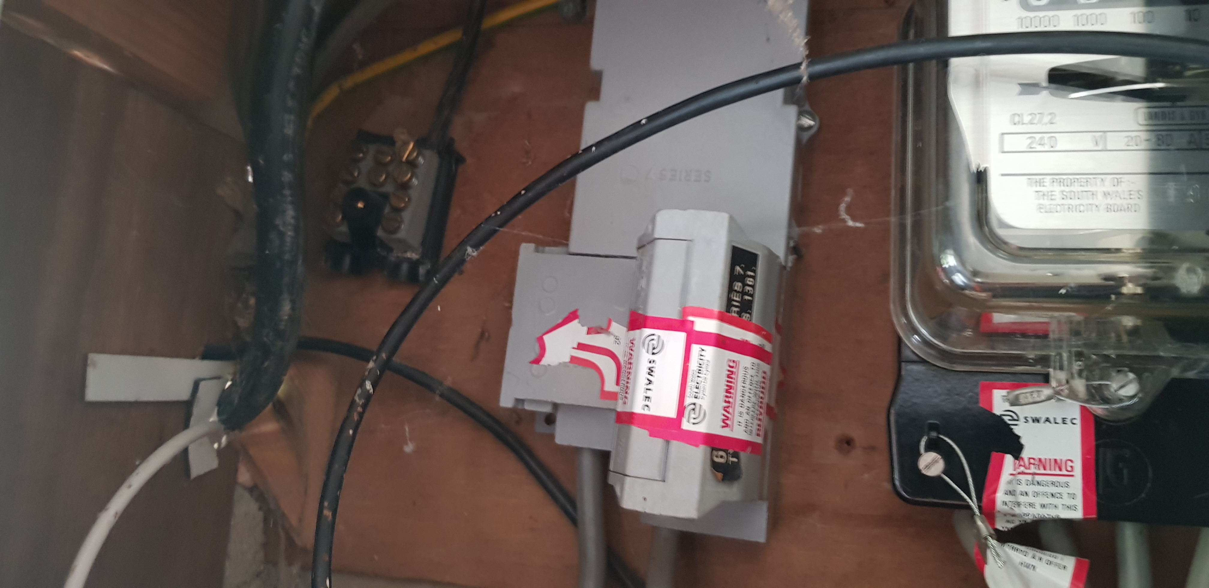

When we finished our work and tested loop impedance we had a result of 85 Ohms (water bond was in place). When investigating we found that there was no link between the main earth of the Tns system to the consumer unit. ( pictured top left incoming earth in Henley block)
We rectified the problem and had a loop impedance of 0.57 Ohms.
The reason for my post is, since finding this I have wondered if a board is not adequately earthed would this prevent an RCD from tripping? As in if the earth is not intact will it provide a path for fault current to flow and trip the RCD?

Where does the black wire coming in to the smashed Henley block come from?
TNS system. The pole transformer was only outside, 2 core cable to cut out and separate earth into the Henley block.
Has it, and how has it, been confirmed as TNS?
I'm curious as this sounds like an unusual supply setup to me
The supply transformer was no more then 20m from the property. Cables ran over head, 1 2 core cable for live and neutral and one conductor for earth. Unless I'm mistaken this is TNS, isn't it? The earth conductor looked like a bare conductor painted black. It didn't seem to be pvc insulated.
It does sound like TNS, just a pretty unusual way of it being supplied.
